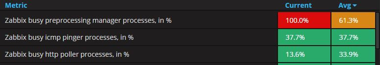

    • I have a Zabbix dashboard in Grafana and it says that "Zabbix busy preprocessing manager process" is at 100 % at various times.

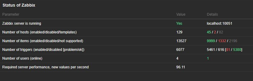

      Below are the zabbix stats before adding vcenter.

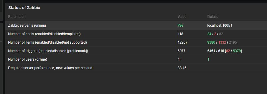

      Stats after adding vcenter

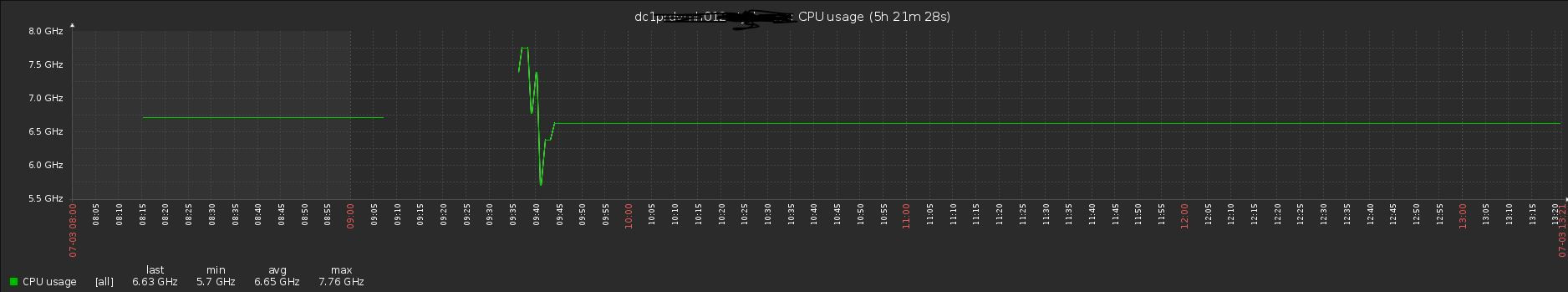

          I have just added VCenter server back into Zabbix this morning so I will keep my eye on it to see if the issue occurs again. Zabbix server seems to stop at around 17:00 - 18:00 and I have to restart the following morning.
          CPU and memory stats are still not updating, I had some probs with the changes I made in the config file this morning so server was offline as you can see, then Zabbix appeared to update stats for about 10 minutes then nothing after that,

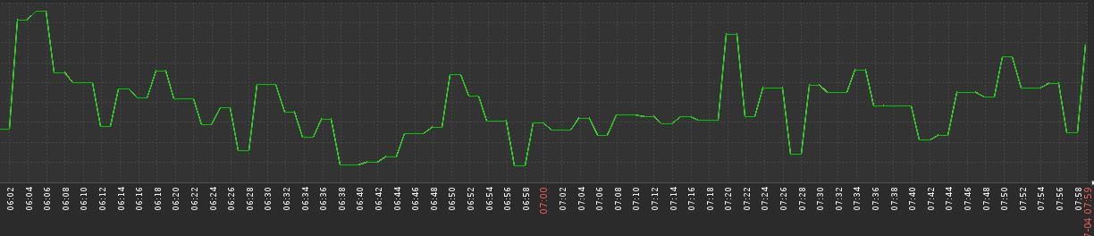

            So I monitored the performance of Zabbix last night and this morning and it looks like that any performance related issues co-insides with our VMware backups. I ended up disabling VMware Event log checks in the standard VMware template. Looks like Zabbix server has held up and did not stop overnight.
            Looks like CPU and memory stats are now updating as required. Might have been the simple fact of re-adding the VCenter server back to Zabbix after upgrade to 3.4.11 or the disabling of the VCenter log check
