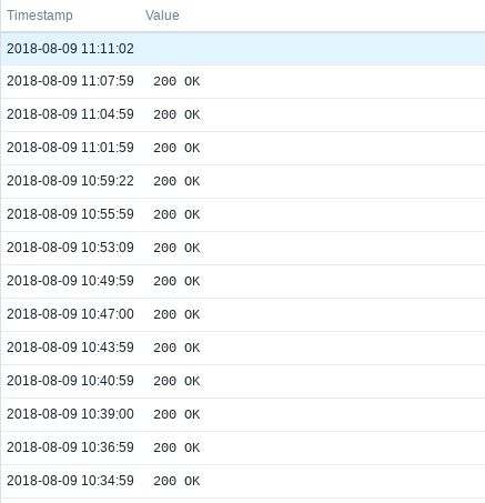

      Hi dimir,
      the expression looks like this:
      {Bluecoat-Threatpulse-Test:web.page.regexp[test.threatpulse.com,/demo.php,80,"^HTTP/1.1 .*",,].regexp(200 OK)}=0
      So sometimes I don't get the data but this is not an error which should be alerted (only after 3 times)
      Any idea?
      Regards, Chris

              I want to create a trigger expression like follows:
              - String is not "200 OK" or last 5 values are empty.
              Since you specifically look for "200 OK" I suggest to fetch this particular value, so change you item to:
              web.page.regexp[test.threatpulse.com,/demo.php,80,"^HTTP/1.1 (.*)",,"\1"]
              And the trigger expression to:
              {Bluecoat-Threatpulse-Test:web.page.regexp[test.threatpulse.com,/demo.php,80,"^HTTP/1.1 (.*)",,"\1"].str(200 OK)}=0 OR {Bluecoat-Threatpulse-Test:web.page.regexp[test.threatpulse.com,/demo.php,80,"^HTTP/1.1 (.*)",,"\1"].count(#5,"",eq)}=0
