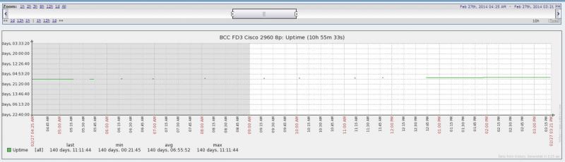

            In my case, zabbix DB running on the same host as zabbix server (it's HyperV vm). Proxies are running on different locations (active proxy) with own databases (mysql or sqlite).
            When problem appear I checked mysql server status and it was running but zabbix can not connect to it and write data. Please look at attached graph - it seems that some data was stored.
