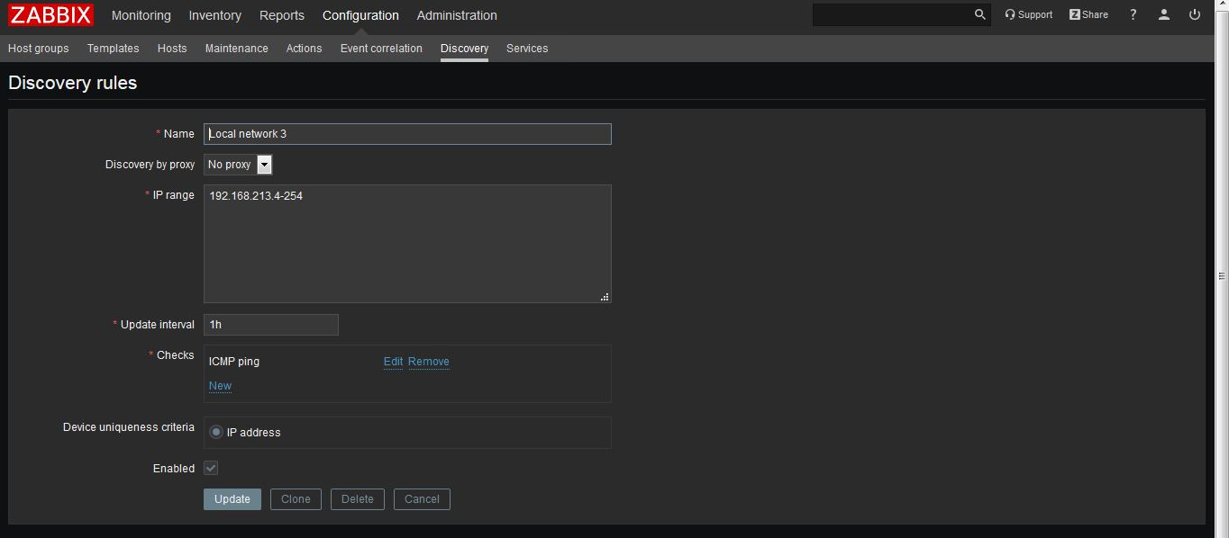

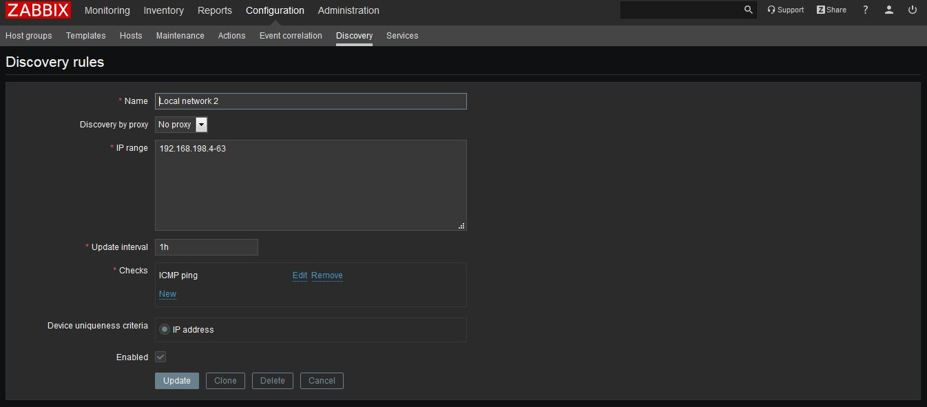

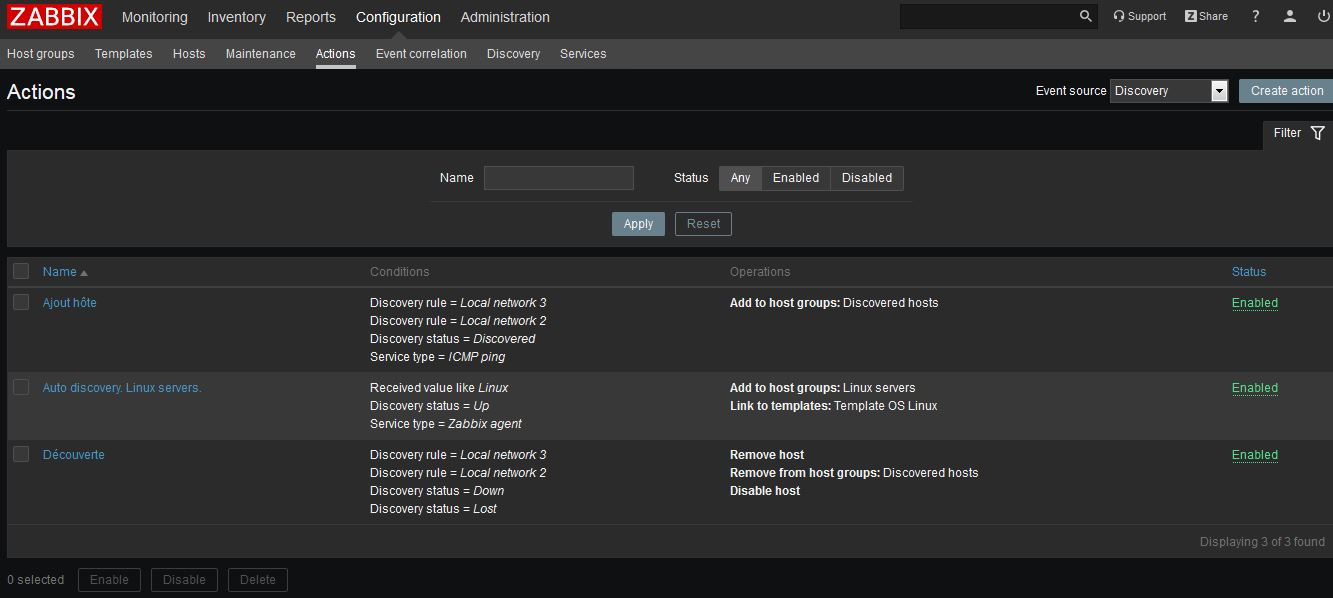

              Pls send some pictures of the discovery rule or the whole setup thx.
              • olidel
                • Sep 2018
                Sorry for the delay but this is what I have. Please note that in the action -> Operations, there is no "send e-mail". Although I'am still receiving emails.
