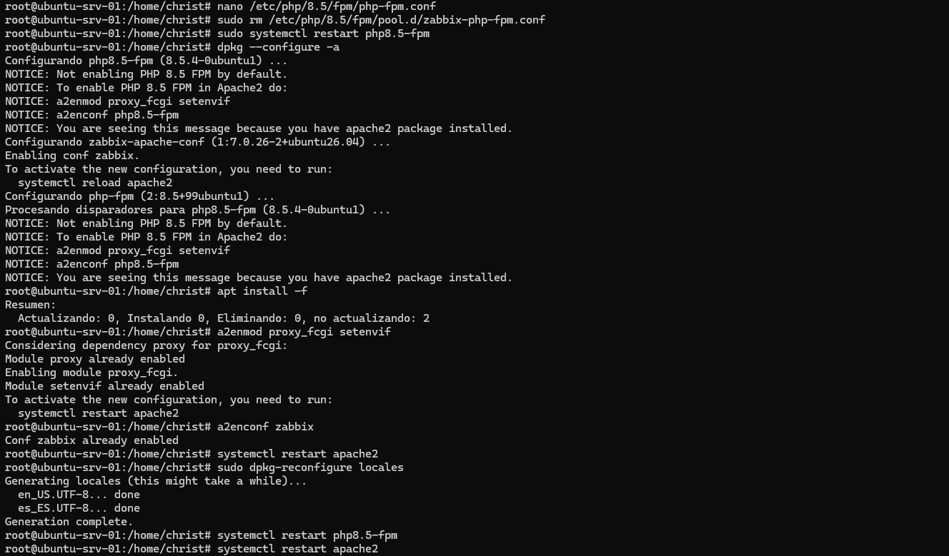

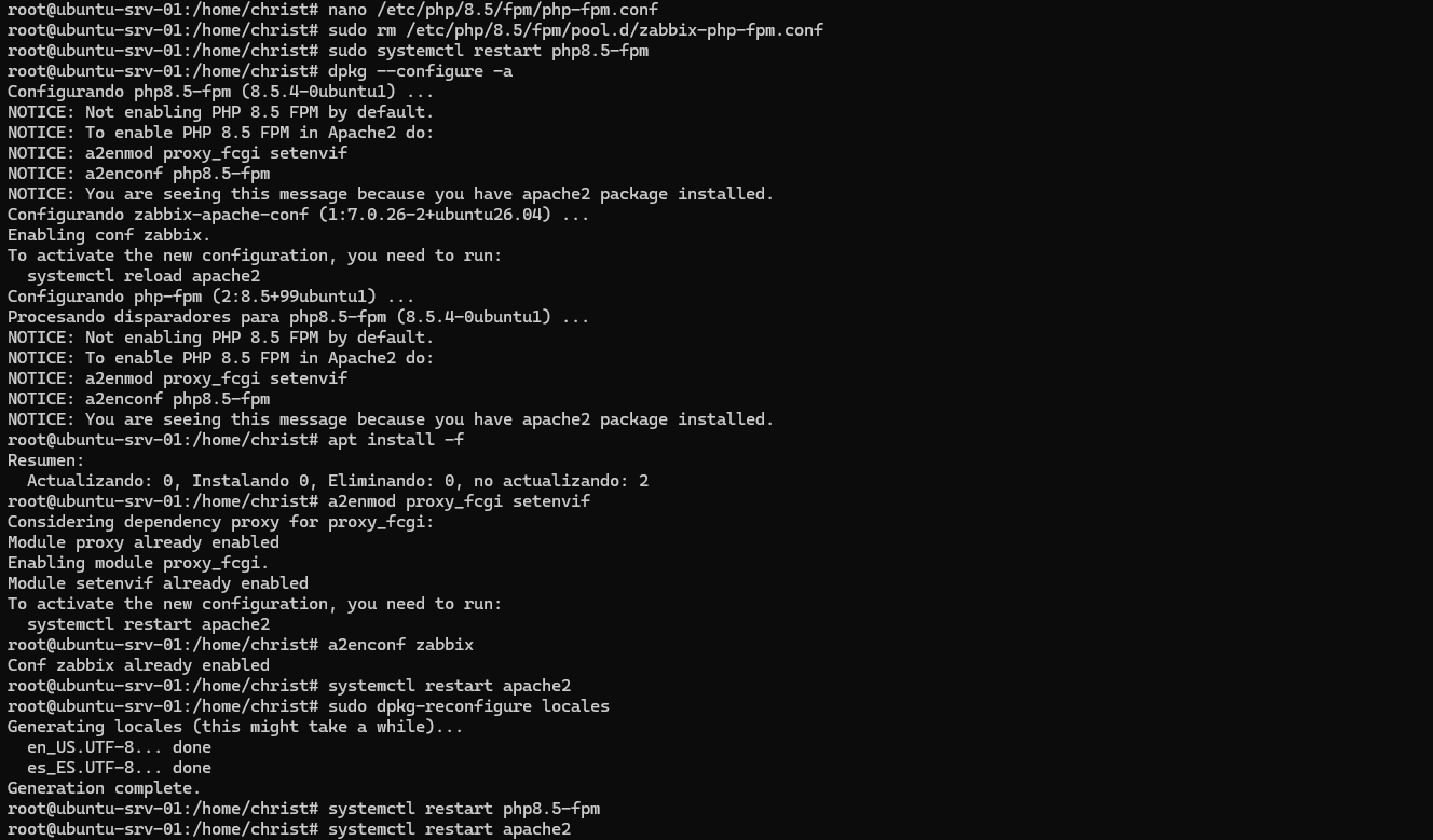

                • syschrist
                  • May 2026
                  If the solutions above doesn't work, try this:
                  php-fpm8.5 -t
                  sudo rm /etc/php/8.5/fpm/pool.d/zabbix-php-fpm.conf
                  sudo systemctl restart php6.5-fpm
                  sudo dpkg --configure -a
                  sudo apt install -f
                  sudo a2enmod proxy_fcgi setenvif
                  sudo a2enconf zabbix
                  sudo systemctl restart apache2
                  Here's some screenshot, I really hope it can help!
ID:	513584 ​ Click image for larger version
