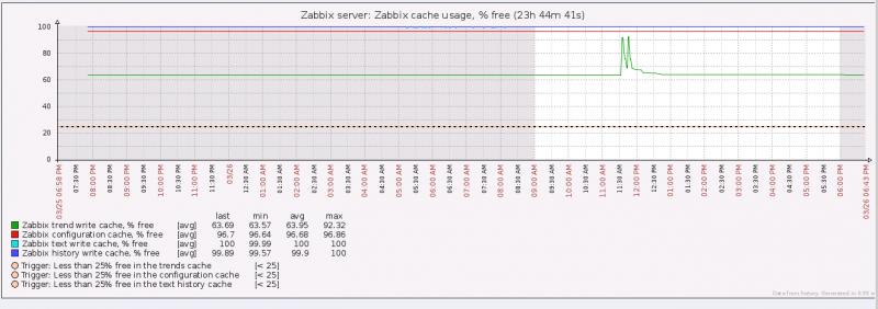

    We have asked you for information (that you have not provided) to try and help you out. As I have mentioned in this thread, these graphs are going to tell a lot about your setup and what may need tweaking.
    Provide a 24 hour view of Zabbix Internal process busy graph, Zabbix data gathering process busy graph and Zabbix Cache usage graph.

          Here is the link to Internal and cache graphs.
          http://tinypic.com/r/o56c93/8
          http://tinypic.com/r/2j2tjbo/8

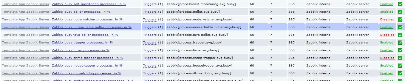

                  Look at the items for your Zabbix server and specifically the items that belong to Template App Zabbix Server. Is there any indication of them "Not supported" or "disabled"?
                    No. Everything is enabled and there are no errors.

                          Are you looking at the items via Configuration --> Host --> Items, or are you looking at Configuration --> Templates --> Items ?
                          You need to look at Host --> Items.

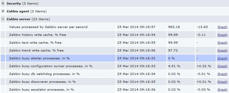

                          And if that is where you see they are enabled and with no errors, then what are you seeing under Monitoring --> Latest Data --> <Zabbix Server> then under the category of "Zabbix Server" ?
                          If they are reporting correctly, you should see data there similar to this:

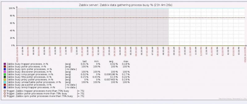

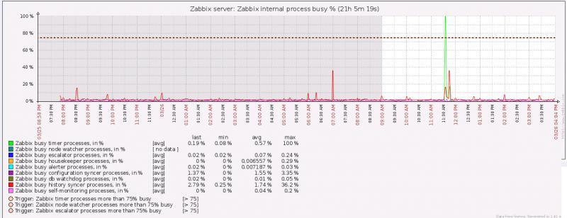

                              Here are the graphs. It looks bad. Server performance (Ram and CPU) is normal FYI.
                                It might look bad, but the good news is that now you know what needs to be adjusted. On your Zabbix server in zabbix_server.conf:
                                Increase:
                                StartPollers=xx (Increase by 10 or 15 at a time until stable)
                                StartPollersUnreachable=xx (try 10 or 15)
                                StartDiscoverers=2
                                TrendCacheSize=64M
                                Leave StartDBSyncers=4 (Do not change)
                                Make sure all the above lines (if changed from default) are not preceded by a comment # or they will use the default settings. Restart your Zabbix server process. Give it 10 or 15 minutes then check your graphs graphs agin. Adjust settings as further necessary.
