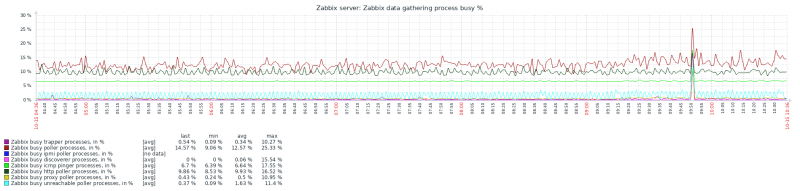

    - The zabbix data gathering processes show only about 15% busy, see attached image. (we have around 12000 items all up), similar graphs for the proxy show no discernible problems.

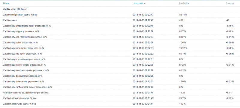

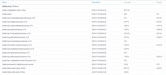

      Additional graph showing proxy usage.

Name:	Screenshot_2018-11-30 PRD Zabbix Latest data [refreshed every 60 sec ].png
