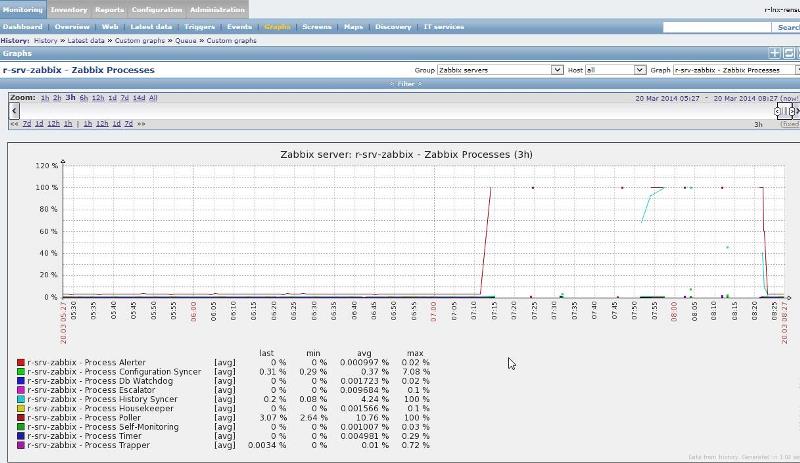

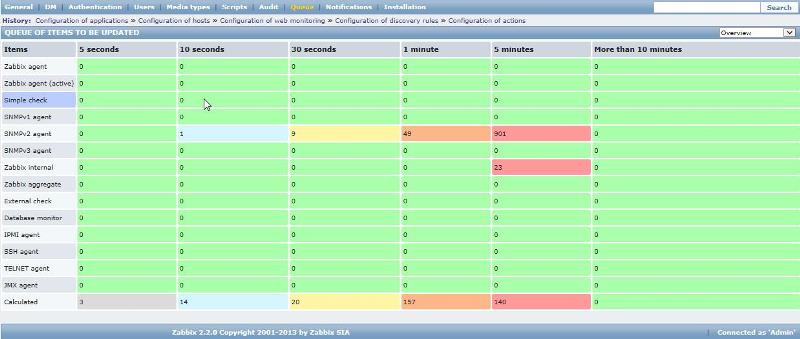

    Every morning during about 1 hour I have problems with SNMP Polling. Many items are waiting to be updated. Processes poller and syncer are 100% busy.
    I don't see any specific system process running at this moment.
    I have many calculated items. Is it a possible problem? How can I optimize the installation?
    Thank you
    Patrick
    Some screenshots :Zabbix-Processes and items-queue

    Hi Patrick. It looks like you are using many of the Zabbix default values, such as StartPollers=5
    There are a a few other graphs regarding Zabbix processes which you should also look at. Please refer to the bottom of my post here: https://www.zabbix.com/forum/showthread.php?t=41219
    You need to look at all of these to make an informed decision on what parameters to adjust. Certainly take a look at your cache graphs and see how well that is performing. I have had to adjust my cache settings several times as I add in more and more monitored hosts.
    But at first glance from what you have shown, I would increase your StartPollers to maybe 15 and see if that helps.
    Also in your zabbix_server.conf file is a setting for Timeout= which by default is 3. Try bumping that up to 10 or 15.
    Any changes to zabbix_server.conf require you to restart the Zabbix server process.
