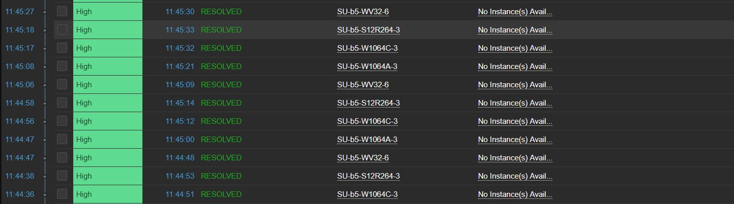

    After reverting to a month old DB schema (Postgres), I started getting thousands of the following problem notifications:
    The host is healthy and I can't see anything relevant on the server log.

        Apologies for not sending the complete data needed, I will try to answer all your questions:

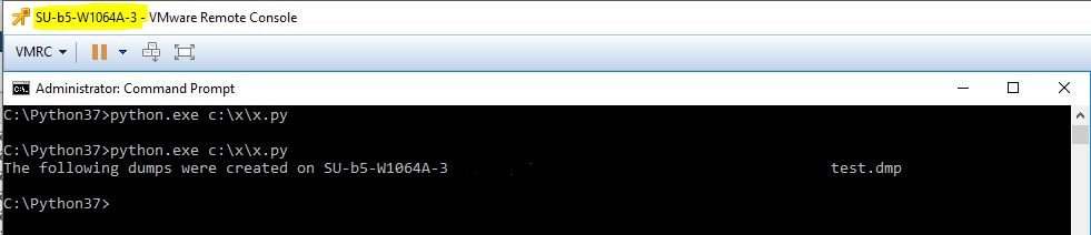

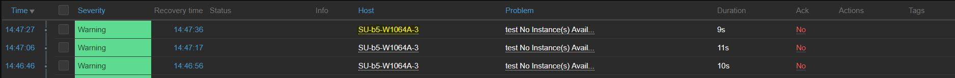

        1) what kind of metric is behind your trigger? - This is a trigger that looks for dumps in a given directory, if the script returns any value than it is triggered.
        Here are two examples of what it looks like when it returns nothing and returns a value: (not that this exact machine returns " No Instance(s) Available." for the script that we can clearly see that is working)
        ​​​​​​​ Click image for larger version
