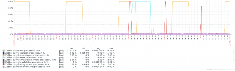

    I'm facing a problem that sometimes I will receive alerts like "Zabbix agent is unreachable for 5 minutes", but when I check the latest data of item agent.ping for that server, I found actually there is data during that period.
    I'm using build-in "Template App Zabbix Agent" without doing any change.

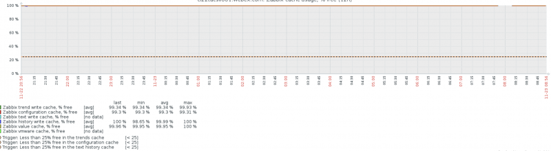

    When I check the performance of internal process of zabbix, I find that the history syncer process is very busy at the point problem happen.
    Besides history cache is almost not used at the point problem happen as well.
