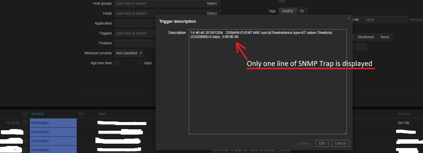

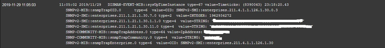

      Have the same issue with {ITEM.VALUE} multiline display. I made several triggers on SMMP Traps. Zabbix receive SNMP Traps through smnptrapd + zabbix_trap_receiver.pl script.
      I can see incoming Traps in Latest Data history.
      All lines of Trap are displayed.

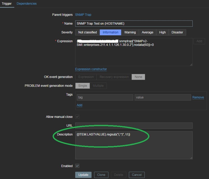

      I want to see all these lines in trigger description. I use
      {{ITEM.LASTVALUE}.regsub("(.*)", \1)}
      expression in description field of a trigger.

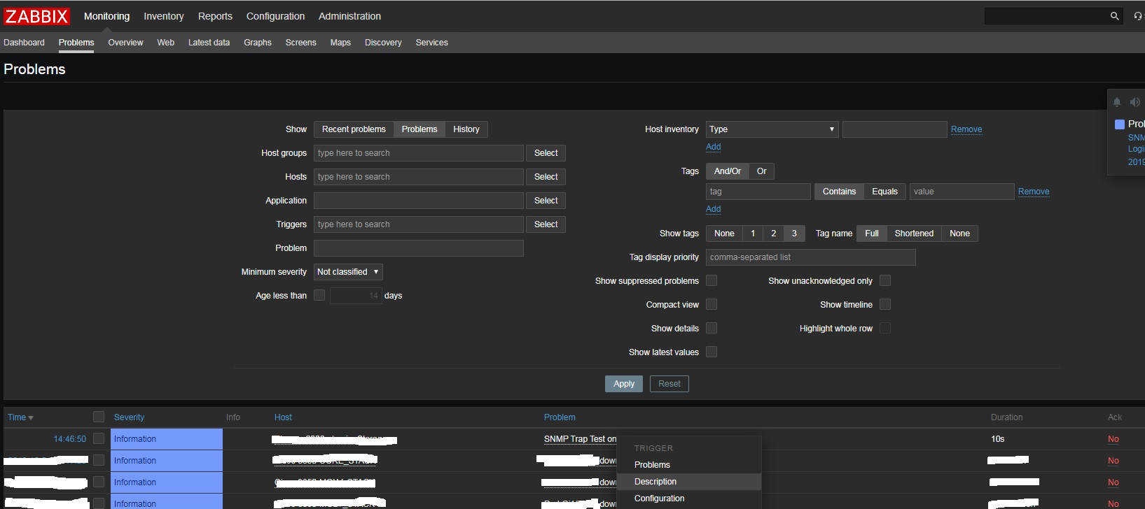

      But when a trigger is launched I can see only first line in of an Snmp Trap in Problems Menu.
      Is there any way to see all Trap message in Trigger description field?
