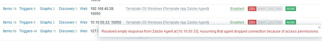

    I'm getting below error from Host configuration:
    (Received empty response from Zabbix Agent at Assuming that agent dropped connection because of access permissions.)
    Zabbix Agent has been installed on windows host and service is up
    ZBX icon is red and no data collected from host
    what access permission should i do.
