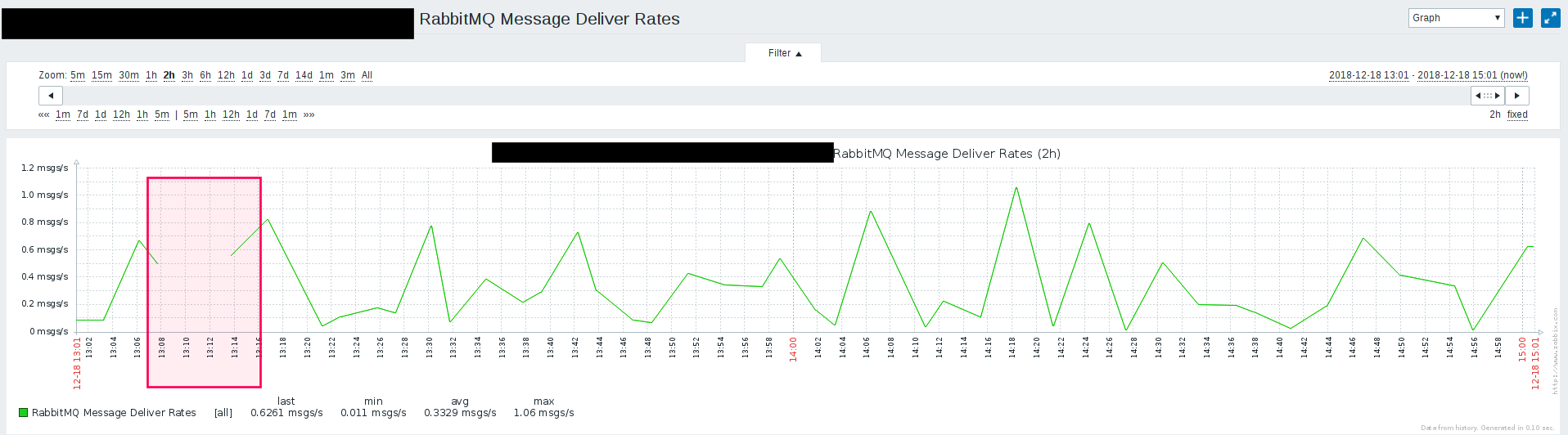

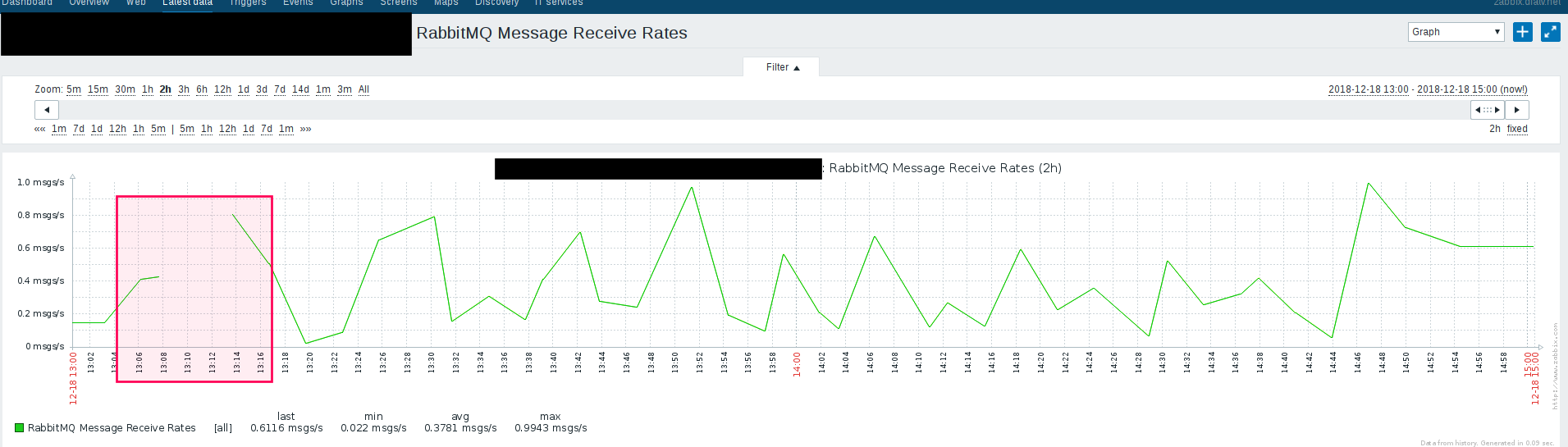

    Hello guys,
    I'm having this strange issue where only 2 graphics (2 items) from the same server same template are having the following issue... when you check the graphics for " RabbitMQ Message Deliver Rates" and "RabbitMQ Message receive Rates" you can see holes (missing data) on the graphic. We check this manually and the check works ok, we also create 2 cron jobs, inside the server, checking the same data and with the same Update interval and that cron job show us on the logs the data is there, while the graphic on zabbix-server show missing data:

    And now the other...
    The rabbit server is a linux. The zabbix-server is 3.0.14 version, and the agent: 3.0.16
    Both check are being run as "zabbix-agent(active)
    The rabbit server is being monitoreby proxy, but we already test doing it without it, and the problem remain.
    If you have any ideas, it would be really appreciated.

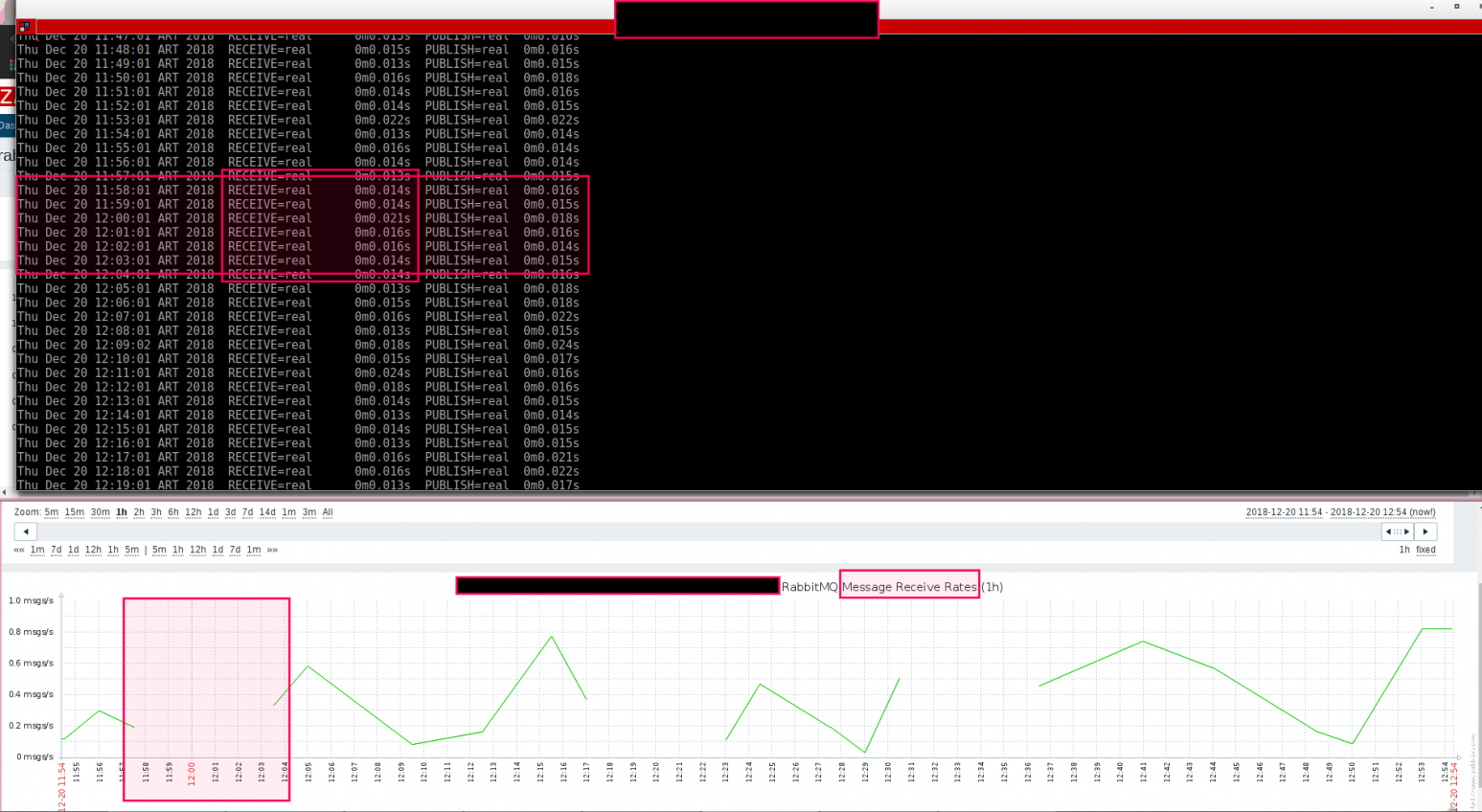

            • karmukis
              • Aug 2014
              • 37
              dimir I created a small script, using my check and your line.... and the tmies I get are actually not bad, here is an example of the RABBITMQ MESSAGE RECEIVE RATES... you can see the gap in the graphic and the data on the server. The script is running every minute.
              The script is running inside the zabbix-proxy that checks the rabbitserver, in order to siulate the true item...and as you can see the times are not that bad, neither so different to other times where we are not seeying gaps on the graphic.
              Any ideas?
              Click image for larger version  Name:	zabbix-rabbir.png Views:	1 Size:	694.5 KB ID:	371017
