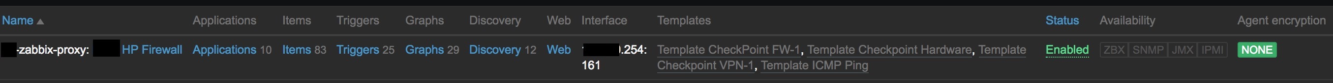

    I noticed something in my Zabbix Server and Proxy. I tried to monitor our Ubiquity APs and the templates required were successfully imported. I added hosts and noticed that if I use a proxy, the SNMP host availability status indicator is not enabled, but if I don't use proxy, the host availability status SNMP turned green and it collects data.
    I missed something?

    hi alamin thanks for the reply. i have working proxy, my concern is that some hosts such as an Ubiquity and CheckPoint devices when uses a proxy, the Availability "SNMP" didn't turned in to green and no data were collected. But, if I don't use a proxy and the hosts uses the Zabbix server, the SNMP status in Availability turned to green and is collecting data. i also added required MIBs in every proxy just in case.

Name:	Screen Shot 2018-12-27 at 9.05.18 PM.jpg

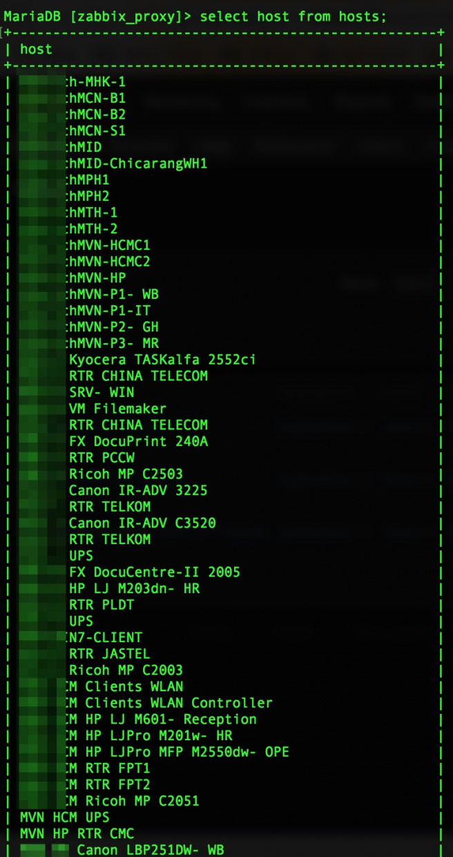

                    Could you run the following SQL query on your proxy database?
                    select host from hosts;
                    • Deriuz
                      • Feb 2018
                      • 13
                      Originally posted by dimir
                      Sorry, was on vacation.
                      I noticed that my host (CheckPoint firewall) does not appear in the list even I select the correct proxy. The name of my host is MVN HP Firewall, but it's not in the list.
                      • dimir
                        Zabbix developer
                        • Apr 2011
                        • 1080
                        Please check that the Proxy name configured in Frontend is correct and proxy configuration file contains correct IP for the Server (Server=x.x.x.x).
