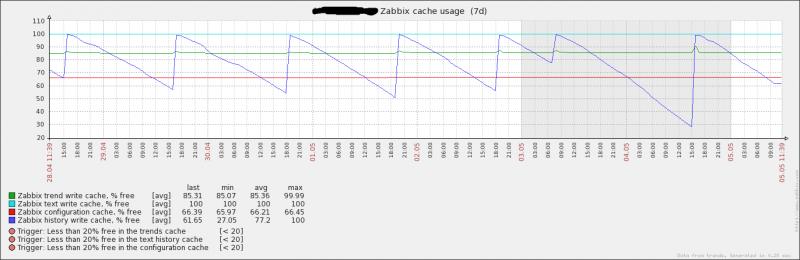

    Just recently have noticed an issue where the history cache is filling up. I have restarted the zabbix server processes and the cache will clear and then slowly begin to fill back up again.
    The cache does not fill up quickly, and would say it is about 1% an hour. The only way it recovers is if I restart the services again.

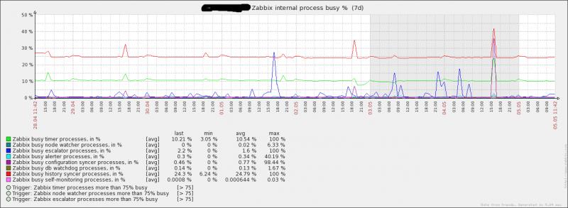

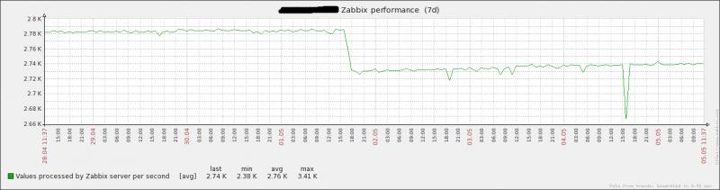

    Attached are grapsh frot he alst 7 days to help illustrate what I am seeing. The changes in the history cache is me restarting the zabbix services as in past when the history cache fills, data to be processed falls behind.
    Any other thoughts?
