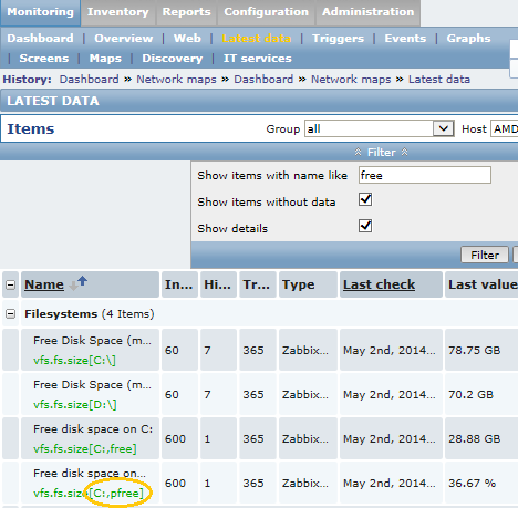

        • aib
          • Jan 2014
          • 1615
          #19
          There is my Latest Data
          Notice that my key is vfs.fs.siz[C:,pfree]
          After the discovering process done, the real host has the real items with real name of drive.
          When you create Template (Items/Triggers/LLD), you can use macros {#FSNAME}.
          When you monitor the real host - you have to use the real name.
          Do yo understand my bad English?
          Sincerely yours,
          Aleksey

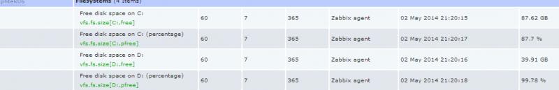

                      • felixn
                        • Feb 2014
                        • 31
                        #26
                        Hi
                        I don't get it, I have another host now that just will not trigger. When I look at the triggers (generated from the discovery) it looks just right and latest data reports a number much lower.
                        last data:
                        Free disk space on /data/p4depots/prj_pro (percentage)
                        vfs.fs.size[/data/p4depots/prj_pro,pfree]
                        60
                        7
                        365
                        Zabbix agent
                        02 May 2014 23:36:44
                        14.3% (free percent)
                        trigger:
                        Mounted filesystem discovery: Free disk space is less than 20% on volume /data/p4depots/prj_pro {cphyyyy:vfs.fs.size[/data/p4depots/prj_pro,pfree].last(0)}<20
                        I am getting crazy here
