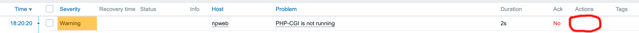

    Here is what the Problems table shows when an example problem occurs:
Name:	Screen Shot 2019-02-06 at 6.20.54 PM.png
    As you can see, no actions are generated.
    Any ideas? Thank you!
  • DmitryL
    • May 2016
    • 278
    Make sure that user group which is mentioned as a recipient in your action, has at least read permissions to the host group in which this npweb host is.
  • sknight
    • Feb 2019
    That was it! I know it had to be something simple I was missing. Thanks.
