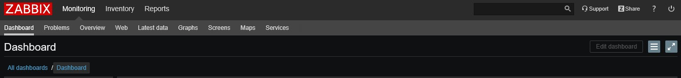

        After many attempt of refresh in IE 11 browser the dashboard came out but it is not the payout of the version 3.4.7 that we have set.
        Also the Configuration and Administration part is totally missing
        I am using the standard login admin which have super admin rights.
        I have screen capture for reference here.
              According attached screenshot i assume you opened frontend as "Guest" user which does not have rights for Administration part at all.
              Did you used "HTTP Basic Authentication" in your previous version of frontend? If so please refer to authentication http://www.zabbix.com/documentation/...authentication.
