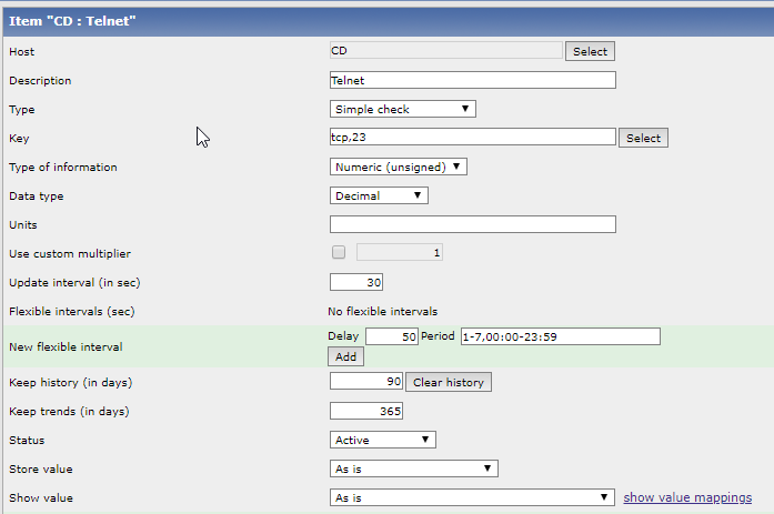

      I have to define the service and it's a non standard implementation of Telnet.
      Connecting to the system returns a login screen and none of the expected list of terminators is returned.
      As I said in a previous version I was just using Simple check tcp, 23
Name:	2019-02-20 16_03_54-zabbix_ Configuration of items.png
      This option is not available in the latest version.

        Not sure how old version is that screenshot from
        But this syntax should work:
        net.tcp.service[tcp,<ip>,23]
        From documentation:
        tcp
        Creates a TCP connection without expecting and sending anything. Unlike the other checks requires the port parameter to be specified.
        • DavidAdams
          • Feb 2019
          It's version 1.8.
          Thanks for that, I'd looked at the net.tcp.service check and hadn't noticed the service could be just tcp.
