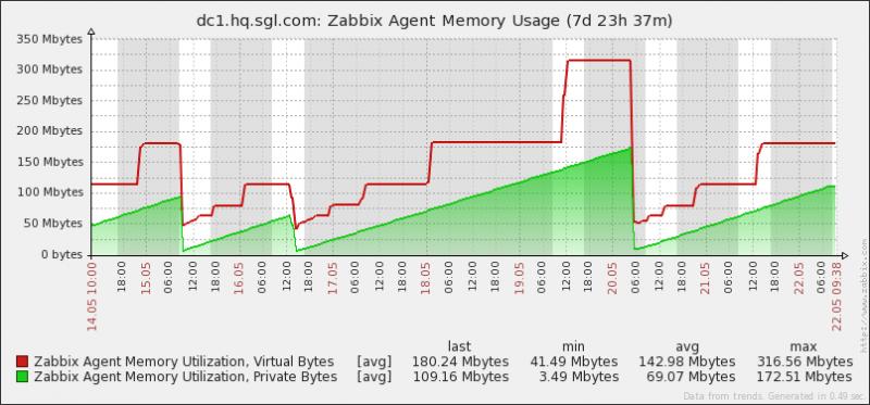

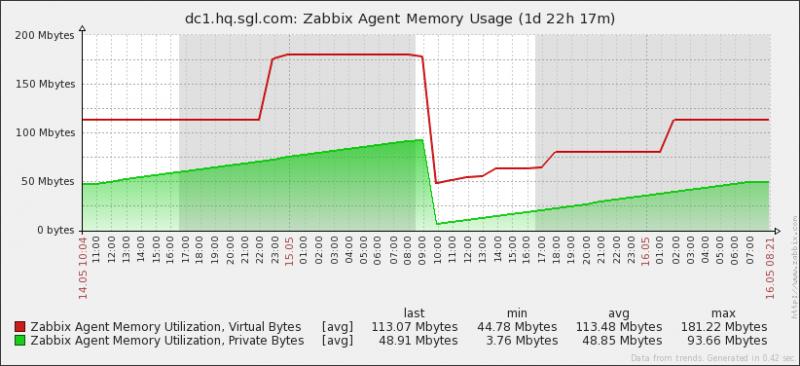

I started to collect data about memory utilization of Zabbix Agent application
On the graph we can see how Zabbix Agent slowly increase the amount of memory which it use.

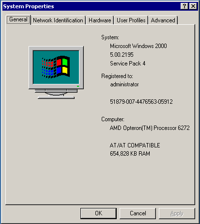

Server OS : Windows 2000 SP4, virtual environment
Zabbix Agent Version: 2.2.1 or 2.2.3
Server Memory: 654,828 bytes
[LIST][*]perf_counter[\Process(zabbix_agentd.e)\Private Bytes][*]perf_counter[\Process(zabbix_agentd.e)\Virtual Bytes][/LIST]
