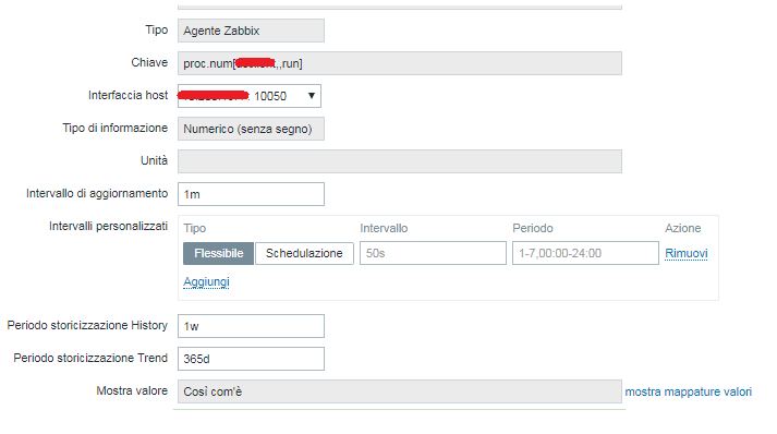

    Hi all,
    I'm having an issue with this trigger
    {HOST: proc.num[process,,run].last()}<1
    I configured the item and the trigger via Web.
    The problem is that Zabbix gets a 0 as a result even if the process is running or stopped.
    I attached the item configuration.
    How can I solve this one?
    Thank you in advance.
