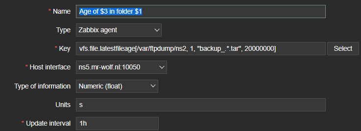

                      I wrote a set of scripts for this 6 years ago
                      latestfileage(), latestfilename()
                      It will give you the age of the newest file in a certain folder and you can give some filters like minimal size and name.
                      Look at the code to find out how it works.
                      I'm using it to test if a back-up has been made.
                      I also made a script to get the age of the oldest file in a tree structure. oldestyoungestage()
                      This is handy if you have a folder in which you have folder where devices upload their config back-up (like 3CX).
                      It does this every night....
                      If one of the 3CX's doesn't back-up anymore, it can warn you....
                      /etc/zabbix/zabbix_agentd.conf:UserParameter=vfs.file.latestfilename[*], sudo /usr/local/sbin/latestfilename "$1" "$2" "$3"
                      /etc/zabbix/zabbix_agentd.conf:UserParameter=vfs.file.latestfiledate[*], sudo /usr/local/sbin/latestfiledate "$1" "$2" "$3"
                      /etc/zabbix/zabbix_agentd.conf:UserParameter=vfs.file.latestfileage[*], sudo /usr/local/sbin/latestfileage "$1" "$2" "$3"
                      Click image for larger version  Name:	image.png Views:	1 Size:	16.4 KB ID:	451016​
                      Click image for larger version  Name:	image.png Views:	1 Size:	18.2 KB ID:	451015​
