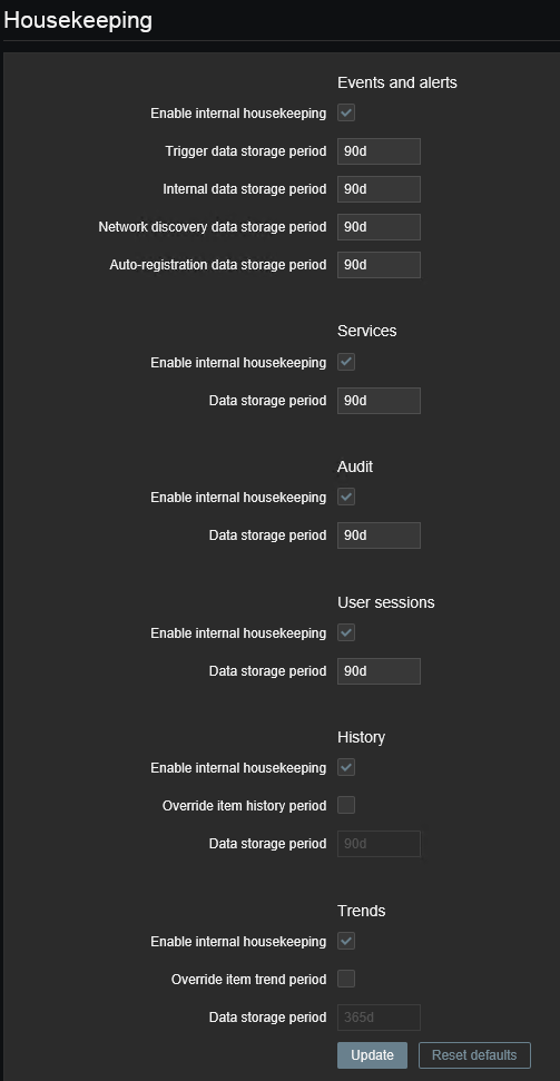

    Additionally I check the Housekeeper configuration (picture adjunted) and i think that it's OK. This configuration it's changed 1 month ago.
    We have a disk with 128GB and now it have only 8gb free

    How you have set Haousekepeer in zabbix_server.conf?
    You try up interval item from 1 minut to 2 minut or 30s to 2m on the host?
    In your picture you store data 270 days .. I story raw data from 30 days and trend data from 90 days..

      I have reviewed zabbix_server.conf and it don't contain any Housekeeper parameters, I don't know how they installed first time.
      When you say "In your picture you store data 270 days .. I story raw data from 30 days and trend data from 90 days." I understan that 30 days for history data and 90 days from trend data are default parameters, right?.
      I review my configurations items and I view diferent configurations from History (1w, 30d and 90d) and only configuration from trends (365d)
      Would I have to change the configuration of 270 days for 90 days on housekeeping? (image adjunted)
      Thanks a lot for your reply
