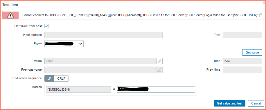

                      • Veravul
                        • Jul 2022
                        The reason is that SQ server DSN does not use user and password in the odbc.ini file ( this depends on security ), just use in the Zabbix item username and password and this will work, or connection string
