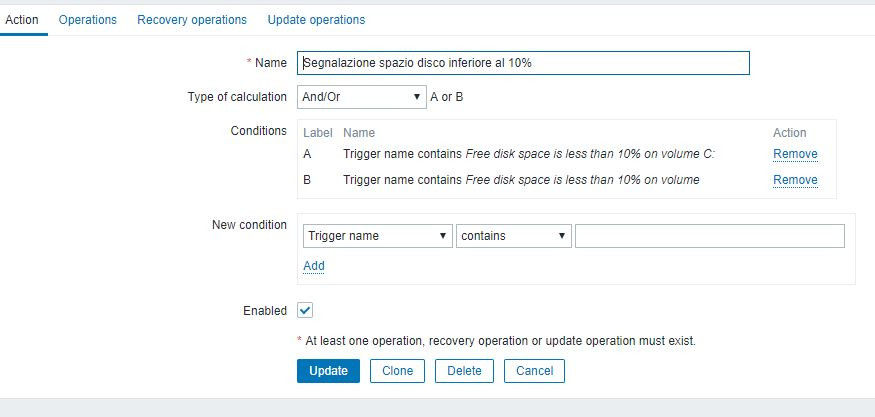

      Hi and thank you for your answer.
      I confirm that the alert appears in the dashboard, but the email alert doesn't arrive.
      Now I paste here my setting for the action.
      I used the "trigger name", is maybe this the error? I didn't find other mode to use this triggers.

        Instead of "trigger" and "equals", use "trigger name" and "contains". If you keep the rest as is, and just change those two parts in the condition, it should start working.

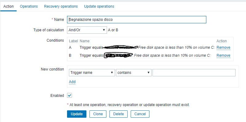

          Hi, I tried but nothing arrived...
          This is my configuration. I tried also to remove "C:" but noting change...

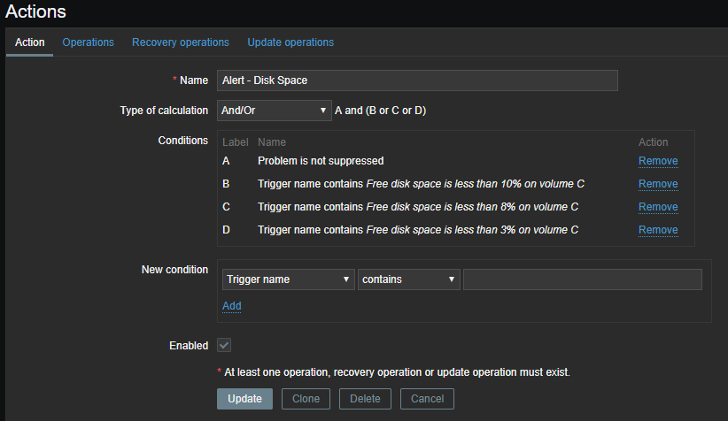

            Perhaps it is an errant space or something? Try copying the trigger name and pasting it into the value field, to confirm? I mean that should work....Here is a copy of my Actions and I have it trigger on three different criteria:
Name:	Screenshot - 4_11_2019 , 3_32_46 PM.png

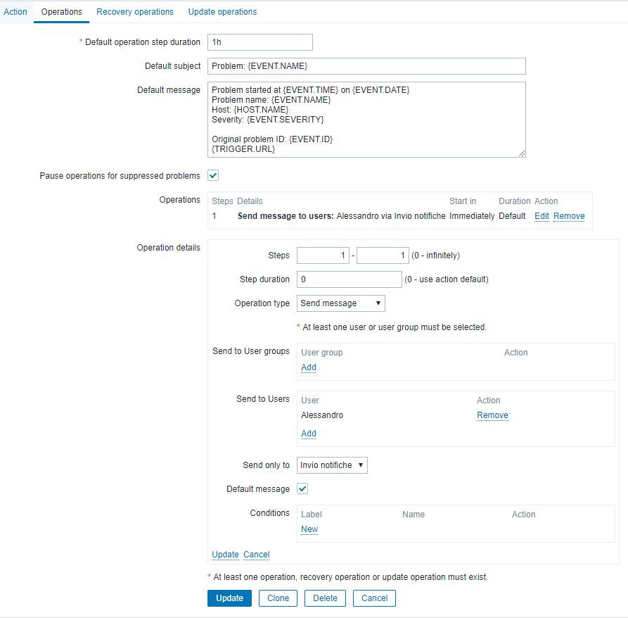

                Do you insert any conditions under the "Operations tab"?
                Thank you

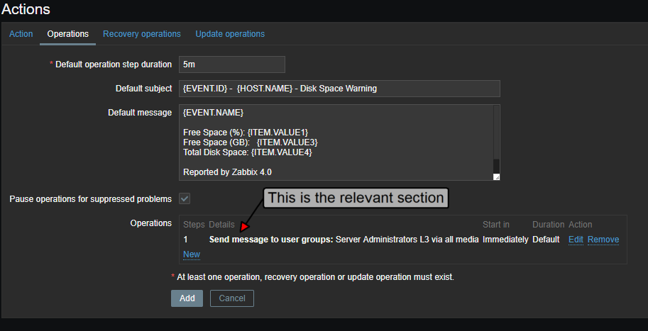

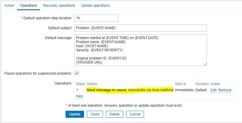

                    Yes, under the Operations Tab, for the Operations section you have to add the send message to user (or user groups, which is what I do).
                    Go to add Operation, then under operation details, choose operation type send message. Then click add in the appropriate field (Send to User groups or Send to Users) and then select the group or user to send it to. Once that is setup, press the Add button, then update (I always forget to press the Add button). When it is done, is should look something like this:
Name:	Screenshot - 4_11_2019 , 4_45_33 PM.png

                        Click image for larger version  Name:	Screenshot - 4_11_2019 , 4_45_33 PM.png Views:	1 Size:	44.1 KB ID:	377437
                        unfortunately was already setting, but nothing arrive
                        "Invia notifiche" is my media type for email that with discovery actions works...
                        Now I'll try to recreate the actions again...

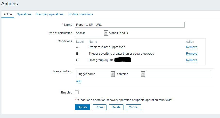

                            Just define severity and the group the CI belongs to

                              Hi scuba. I'll try to set as you screen, but I need email only for disk space alert.
                              However, is strange for me to see that there is no actions setting for the disk space trigger, as attacched image.
                              Any idea?
                              The actions was created yesterday.
