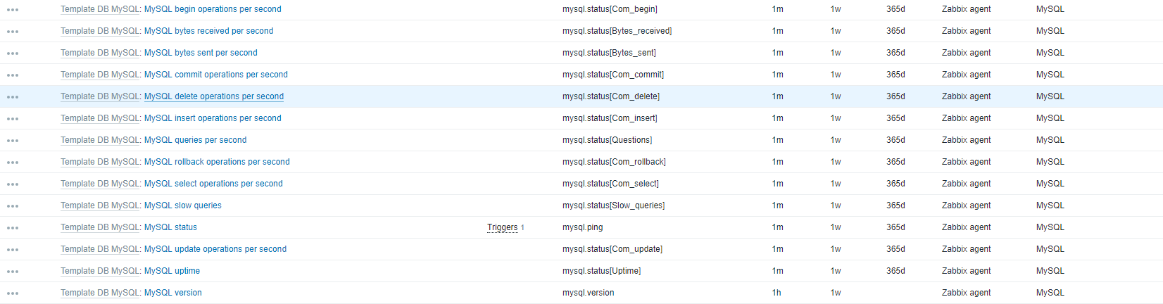

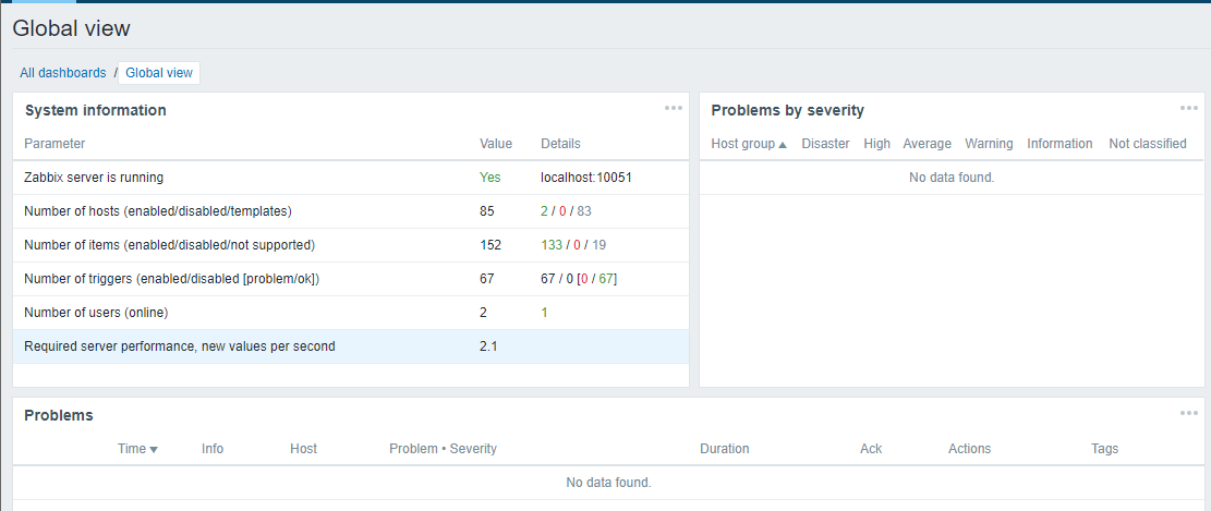

    Hello. I have a strange moment. I install the latest version Zabbix server 4.2
    I install MariaDB 10.3 to my server linux. An agent working correct and I see item mysql.
    If I stop mysql server trigger not send an alert (about problem mysql)
    After stop mysql service Zabbix just shows the message about.
    Possible configure a trigger for send alert if mysql service down?

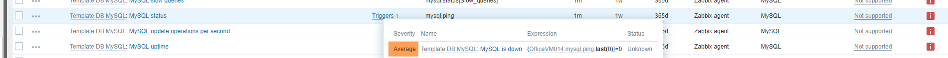

    I find a solution. Need to enable unsupported item.
