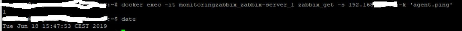

    Sometimes, when zabbix agent is unreachable, zabbix stop check it's state.
    For example, this morning à 11h50 we have lost one of our celery's server :
    Problem started at 11:50:00 on 2019.06.18 Problem name: Zabbix agent on Backend SaaS Celery is unreachable for 5 minutes
    We found and solved the problem but, since 11h50, zabbix never renew agent.ping status however other metrics are OK.
    If I check agent.ping from zabbix server, it's ok :

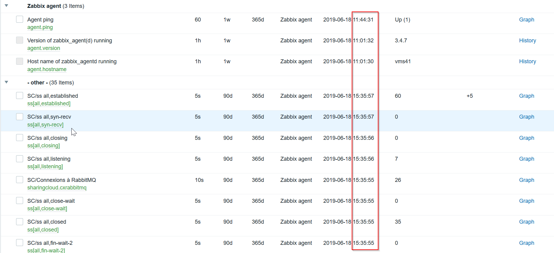

    But as you could see, others checks are OK but agent.ping didn't re-check since 11h50 :
    Click image for larger version  Name:	pb_zabbix_agent.png Views:	1 Size:	152.1 KB ID:	380921
    Could you help me to find my problem ?

    Edit : Problem solved. Server was swapping a lot, swap at 100%. I had to restart celeryd and know it's OK.

    Am i wrong or the Update interval of the ping is lower than the other items?
    If it's, that's the cause.
