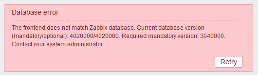

    Hey,
    today i tried to upgrade zabbix server from 3.4 to 4.2 following these instructions:
    but now I am getting this error inside the web frontend:
Name:	2019-07-14 16_13_16-Warning [refreshed every 30 sec.].png
    or as text:
    Database error
    The frontend does not match Zabbix database. Current database version (mandatory/optional): 4020000/4020000. Required mandatory version: 3040000. Contact your system administrator.
    I am running Ubuntu 16.04.
    Installed frontend version matches the server version:
    $ sudo apt install --only-upgrade zabbix-server-mysql zabbix-frontend-php zabbix-agent
    Paketlisten werden gelesen... Fertig
    Abhängigkeitsbaum wird aufgebaut.
    Statusinformationen werden eingelesen.... Fertig
    »zabbix-agent« ist bereits die neuste Version (1:4.2.4-1+xenial).
    »zabbix-frontend-php« ist bereits die neuste Version (1:4.2.4-1+xenial).
    »zabbix-server-mysql« ist bereits die neuste Version (1:4.2.4-1+xenial).
    I already tried restarting the services as well as a complete system reboot. But that did not help. Do you have any suggestions?
    Thanks in advance

      Today I tried with dropping the database and creating a new one. Still the same result. I tried both 4.2 and 4.0.
      I do not quite understand why the error message states that i need an older version of the database. Thanks for your help!
      • zux
        • Sep 2018
        • 97
        wow wow, no need to drop the DB, the upgrade was already done. The only problem here is that the frontend version doesn't match the server version. Did you move web files to a new location? It seems, that even if you updated the package, the web server still servers the old version.
        • igordashaar@gmx.de
          • Mar 2018
          • 7
          Had to copy the files from /usr/share/zabbix to my actual webserver location in /var/www/zabbix.
          I guess thats some kind of newby mistake. But I wonder why this is never mentioned in the update manuals. Does anybody really run zabbix from /usr/share directory? Or is it common to use symlinks here?
