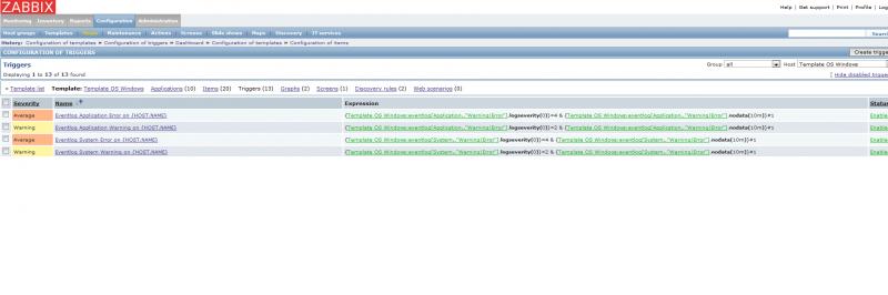

        Hello Ingus,
        i attached a screenshot of the four triggers.
        Kind regards.
        • ingus.vilnis
          Zabbix Certified Trainer
          • Mar 2014
          • 908
          The picture was pretty hard to read due to reduced size, but I guess you did the changes I suggested you.
          So, is it working now as expected or are you still having any issues with your triggers?
