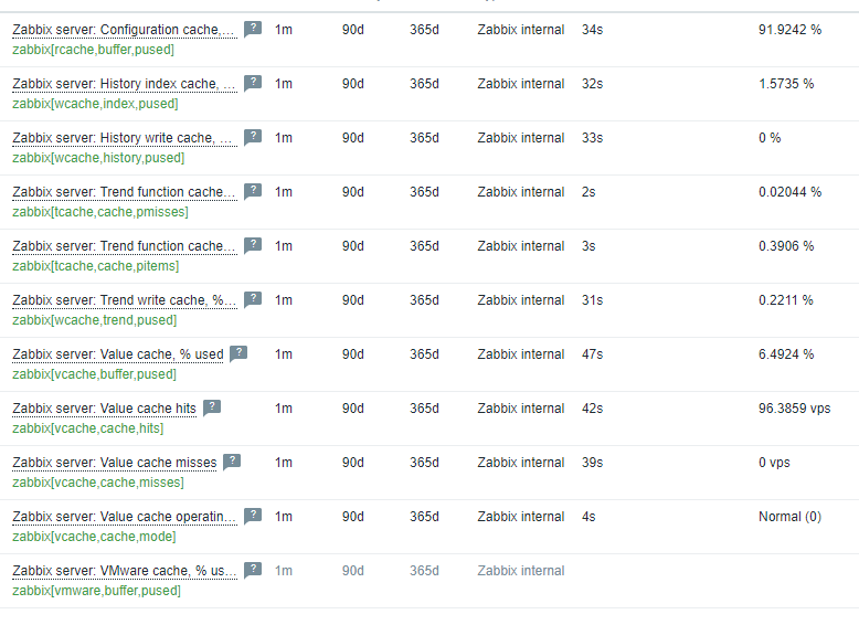

      and the server health dashboard shows a value of 91% usage of configuration cache, but i am not sure what's the total absolute value:

        • 4996
        Cache size is total number... it is for the server to hold config data... If you have default settings its ~32M, I think...? if its already 91% filled, you should increase that number...
        Don't mix up different caches... you ask for value cache (zabbix_server -R diaginfo=valuecache) and then complain about config cache being 91%.. No, your value cache says on that same pic 6.4%..
        You do have limits set in server config... All those ValueCache, ConfigCache etc values there... Your server will crash, if it tries to allocate more than allowed...
        These caches are needed to perform all the tasks. Cleaning them would be harmful. For example value cache holds values to calculate your triggers... it is faster than doing selects from DB each time. DB queries are done only, if you don't have all needed values in cache. "Value cache misses" parameter measures it...

          thanks for the clarification, however i think i am still missing something. Basically the 3 problems i am facing are:
          1. high value of config cache usage
          2. high value of database memory usage
          3. high value of memory usage of zabbix-server (according to the kubernetes metrics server)
          on problem number 1: is it possible to "tell" zabbix not to allocate cache for some hosts? or maybe to simply allocate less cache per host, so that i dont have to necessarily increase to overall ConfigCache value ?

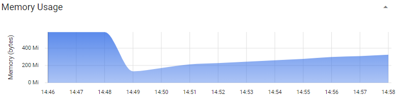

        • is it possible to limit the memory usage on the DB side as well? i am using postgres and i can see that the DB reaches high level of memory (1+GB), which sinks back to about 100MB exactly every hour, i am not sure why, but this does not happen at the same time of houskeeping)
        As reference to point number 3 above, this is the kind of periodic mem. oscillations in postgres i am referring to. They happen very sharply every hour both on replica and master. but the replica seems to have the same frequency but with some lag, maybe about 20 minutes,
        has anyone ever seen something like that ?

          • 4996
          I am trying to keep myself away from anything "container", it is usually only headache...
          But ...
          Here's nothing to do, but increase the value .. if you set it to 64M instead of 32M your trigger most probably goes away.. There is no option to tell zabbix, that do not keep config of some hosts.. What would be the point? All this is needed to perform all the duties, there is no "allocating less memory per host".. You just cannot have half of config .. At one point you will have more hosts and items and then this config just does not fit into memory (cache) and server wont start up or crashes... But server also has to work with those values, so servers memory usage is not limited to just caches summarized.. Caches are there to speed up processing, as accessing memory is faster than doing queries to DB..
          I am not a DBA, but If you have just 1+G memory usage... its basically nothing.. IMHO, Your whole 4G memory is too few for running all of this.. Or maybe I am just spoiled ..:P
          Again, container stuff, I am not going there, I don't know anything about them... ​But all of that 4G is too little amount to run all of it, I think.
          Memory spikes in DB every hour... Just guessing... something with replication? But I am no DBA..​

            well that depends on the data ingestion frequency anyway (IMO). Things is, i would agree with you in general, but from the chart i have shared, it seems to me that the DB would in theory be able to operate at lower memory level, because every hour the memory goes down to much lower levels, and the system works perfectly. Let's see if anyone else out there, having experience with timescale and patroni can support us.
            Also it is worth mentioning that the number of processed values per second stays quite constant, and does not correlate with the sudden drop in memory on the DBs
            again, i have got a couple of zabbix server instances running in containers, and i see a quite beautiful and constant memory usage of about 130 MB ... and this stays like that for quite many days. Only one instance (the one with more hosts then items) shows this strange behavior of ever slowly increasing memory usage ... but the container does not get killed, so it should be cache. This looks to me like a memory leak, if you wish i could provide more details, just let me know what exactly
          • 4996
          No need.. I have no idea what to ask for.
          Shouldn't memory leaks keep leaking until all memory is exhausted and no leak is possible any more? They should not deflate in regular basis...
          I have a gut feeling, that this memory usage issue is something related to that DB. replication, vacuuming... ? Something that primary does at first and then secondary replicates some time later?
          In such a small instance, I don't know, if you even gain anything by using timescale... Just adding complexity there.
