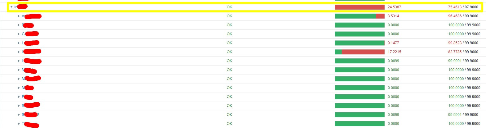

    I have some unclarity in Zabbix 3.2.11 SLA calculation formula and also would like to get some information about Downtime function and period selection in IT services.
    SLA calculation - could somebody please explain me, how SLA and problem time is calculated in here and what is the formula behind it. I have example also given below (SLA example picture). Customer 4 has 13 machines. Customer 4 problem time is 24.6 but totally if I look all this customer machines, there is only 3 machines which have a problem.

      The type of SLA calculation is "Problem, if at least one child has a problem".
      Eg. If customer 4 have 14 machines. Machine 1 have 2 active problems. During the Machine 1 SLA calculation - does the 2 active problems are summed together, averaged together or which way the Machine 1 SLA is calculated if it has multiple active problems?

        What you mean by "problem" here? You think about problems from problems view for some host (machine 1)? It is not like that.
        Think like that:
        IT service in zabbix is connected to trigger (it can be only one trigger). Trigger can be OK/PROBLEM, from that IT service can be OK/PROBLEM. Like you see number of problems on host doesn't matter. State of connected trigger matters. IT service show ratio UP/DOWN for one chosen trigger. You can say something like "that service have SLA 50% so it worked 50% of the time it should worked".
        Now... you have service "customer" with children services - calculation is "Problem, if at least one child has a problem". If one of this children go PROBLEM then it propagates PROBLEM up to parent service "customer" and parent will be in PROBLEM too. If you change calculation to "Problem, if all children have problems" then all children need to be in PROBLEM to propagate it to parent.

          How is the parent (yellow) SLA calculated if the children uptime is much higher?
          • splitek
            • Dec 2018
            • 101
            Hard to tell... but I will try.
            Let say parent configuration is: "Problem, if at least one child has a problem". So our parent go PROBLEM when child 1 or child 2 or child 3 (... or so on) is in PROBLEM.
            Let's draw timeline with every minute. On every minute we put 0 if child is OK, or 1 if child is in a PROBLEM.
            Child 1: 00001111
            Child 2: 11001100
            Child 3: 11110000
            Parent: 11111111
            As you see every one child uptime is higher, Parent have no up time.
            "OR" operation in made in every second on all children statuses and this result is propagated to parent. When result is 1 then Parent is in PROBLEM state.
