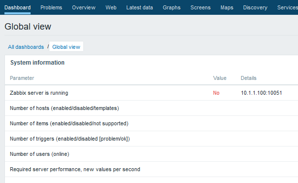

    Hi experts,
    I'm working to put together an experimental Zabbix build on Azure - something that I'm sure has been done a million times before. I think I'm so very close to completing it, but I can't seem to get the Zabbix UI to recognise that the Zabbix server is running when I access the UI via the cluster VIP......
    Click image for larger version  Name:	Zabbix Cluster piv1.png Views:	1 Size:	19.0 KB ID:	383137
    The configuration I have is this :

    As a separate entity, the cluster itself appears to be working fine - if I place the active node in standby Zabbix starts up on the other node. Failback works OK as well.
    I've configured the Zabbix front end server (/etc/zabbix/web/zabbix.conf.php) to contain the following :
    $ZBX_SERVER = '10.1.1.100';
    $ZBX_SERVER_PORT = '10051';
    $ZBX_SERVER_NAME = '';
    i.e. $ZBX_SERVER is set to the IP of the CLUSTER.
    The only change in the /etc/httpd/conf.d/zabbix.conf is to the timezone as usual.

    I have read in various places, such as https://ericsysmin.com/2016/02/18/configuring-high-availability-ha-zabbix-server-on-centos-7/> to update the SourceIP and ListenIP parameters in the zabbix_server.conf with the cluster VIP address. I've done this and restarted the zabbix server, but it makes no difference with theZabbix GUI still insisting that the server isn't running.
    I've probably made a simple "newbie" mistake and omitted or misunderstood something.
    All suggestions as to a solution are welcomed. So far I've thought of :
    1. Do I need to do anything in Azure - the VIP only 'exists' in the context of pcs ?

    The research took longer than I'd have liked, but I'm pretty sure that I've fixed it. I'll try and put together a "how-to" on this when I get the opportunity but for now :
    1. ocf:heartbeat:IPADDR2 isn't appropriate for an Azure environment. It's what sets up the VIP on the cluster.
    2. Using this as the heartbeat resource doesn't tell Azure anything.
    3. Use an alternative resource agent that can interface with Azure
    More to come soon when I've had chance to finish testing and write proper documentation.

          Hi Markku - indeed I did get it working. The documentation I produced is very specific to my environment but maybe the following might help :
          The vast majority of information I got came from here:
          The main thing to do is to make sure that your AZURE load balancer is defined as a resource in PCS :
          Once I'd understood how all that works I was able to configure a PCS resource for the Azure Load Balancer
          [FONT="Lucida Console"]pcs resource create p_azure-lb ocf:heartbeat:azure-lb op monitor timeout="20s" interval="10s"[/FONT]
          Although the command doesn't return an error, looking at the pacemaker GUI (https://<insert pacemaker IP here>:2224/managec/N-PRD-CL1/main#/resources/p_azure-lb ) there is an error regarding not being able to find "nc" (netcat).
          You should also make sure that azure-lb and zabbix-server are co-located and constrained.
          It's important that you understand the theory and concepts of pcs/pacemaker as well as Azure load balancing. Environment tend to vary quite a lot so just listing a whole bunch of commands for you probably won't be doing you a favour.
