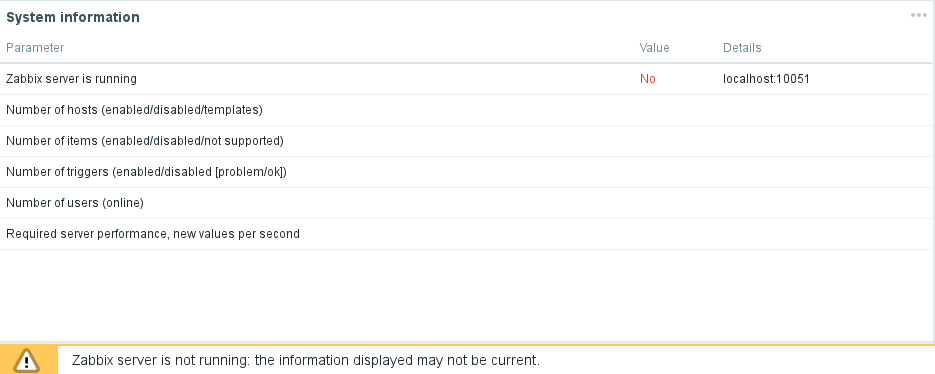

    Zabbix server is not running
    Hi
    We have a Zabbix box with 30 something hosts and a few custom templates. Recently, we receive an error at the bottom of the page that says "Zabbix server is not running: the information displayed may not be correct".
    I've searched this error and made few adjustments but nothing worked and it still happens.
    The error goes away after restart zabbix-server but it comes back after a few minutes and in dashboard > system information > Zabbix server is running turns to NO but I can telnet to the port 10051 from inside and outside of the server.
    Environment:
    OS: Deb 9 x64
    Zabbix: 4.0
    RAM 2GB
    CPU 2Core
    Modified Zabbix settings:
    CacheSize=1G
    HistoryCacheSize=256M
    Timeout=4
    Also, there is nothing in the /var/log/zabbix_server.log file about this issue!
    Any help or suggestion s would be appreciated.

    Hello Mohs3n,
    can you tell me, what value have you set in "/etc/zabbix/web/zaabix.conf.php" web config file?

        Dear Mohs3n ,
        Have you checked StartTrappers value in "/etc/zabbix/zabbix_server.conf" file ?
        if it is commented then uncomment "StartTrappers" and set the default value 5.
        At least one trapper process must be running to display server availability and view queue in the frontend.
        Have you restarted apache service?

            I've made the changes you've asked and restarted both zabbix-server and apache but that didn't fix the issue.

              Hello Mohs3n ,
              1. kindly check few parameters in "/etc/services" file.
              zabbix-agent 10050/tcp
              zabbix-agent 10050/udp
              zabbix-trapper 10051/tcp
              zabbix-trapper 10051/udp
              2. can you make "CacheSize=32M" in "/etc/zabbix/zabbix_server.conf"
              3. cross check the "DBUser" and "DBPassword" in "/etc/zabbix/zabbix_server.conf" it should be same as you have mentioned in "/etc/zabbix/web/zabbix.conf.php".
              Apart from above changes, can you share me "/etc/zabbix/web/zabbix.conf.php" and "/var/log/zabbix/zabbix_server.log" file ?

                I have done everything you've asked but still no change.
