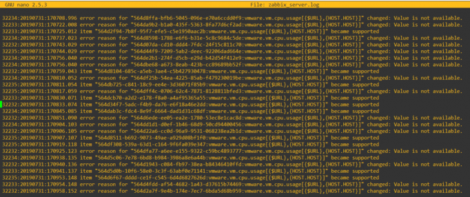

        Just a quick update to demonstrate the problem.
        Here is a picture of my zabbix_server.log right after I enable the item "vmware.vm.cpu.usage[{$URL},{HOST.HOST}]":
        As you can see for some virtual machines the value is supported and for others the "Value is not available". But why does this happen? I need the CPU Usage value for every VM on the ESXi host, is there another way to retrieive this info?
