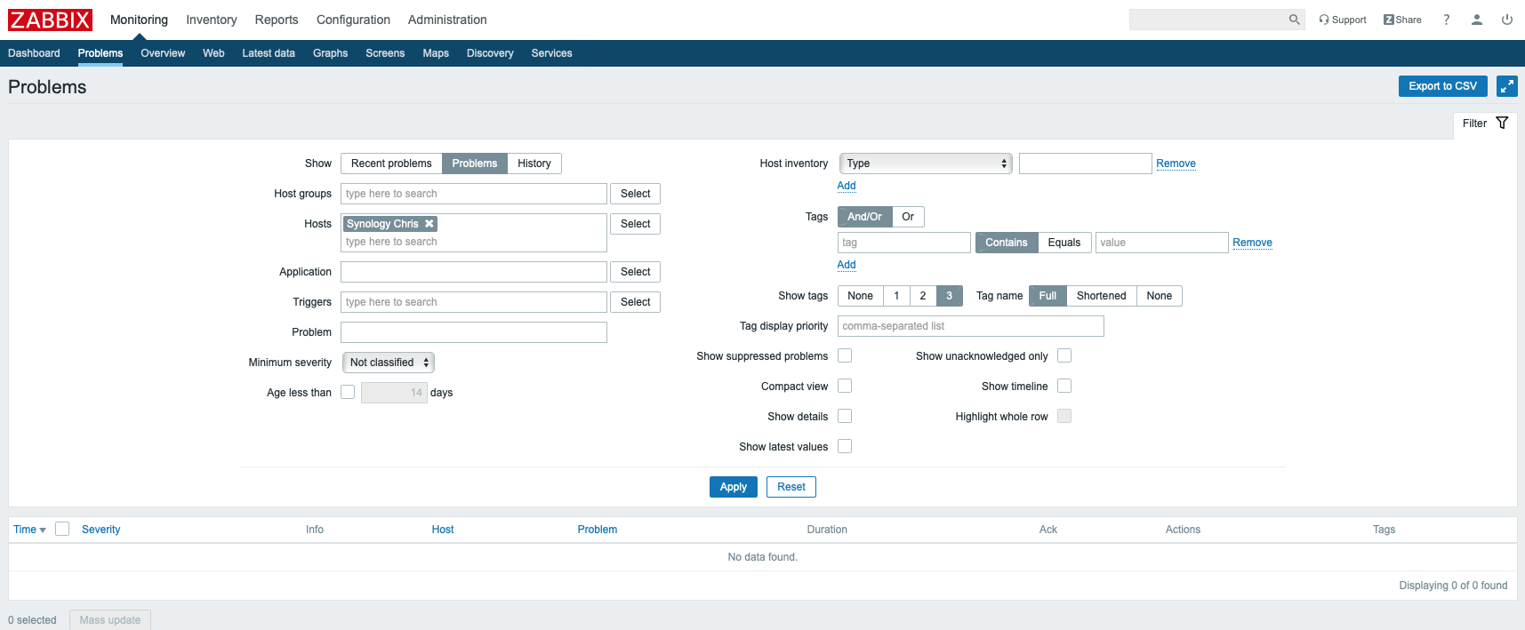

"Problems" on a host, not listed in "Problems" tab and displayed as "OK" on map
  • ybizeul
    • Mar 2018
    • 20
    I have a SNMP host (No using agent interface field, just SNMP Interface) and "Template Module Generic SNMPv2" template.

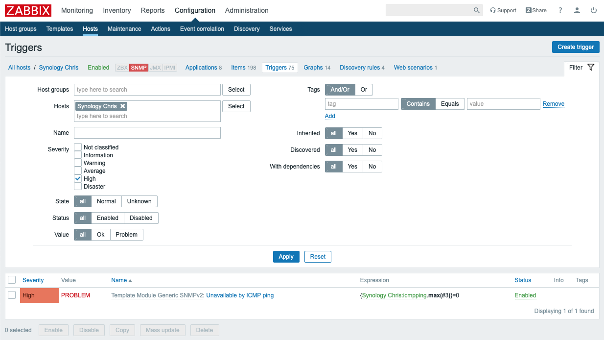

    That template defines "Template Module Generic SNMPv2: ICMP ping" Item and "Template Module Generic SNMPv2: Unavailable by ICMP ping" trigger
    If I look at the host configuration, I see that trigger listed as "PROBLEM" (which is normal as the host isn't reachable)
    But if I go in Monitoring > Problems, and remove all the filters, itis not displayed here
    If I go on the Map, the device that trigger is attached to is displayed as "OK"​​​

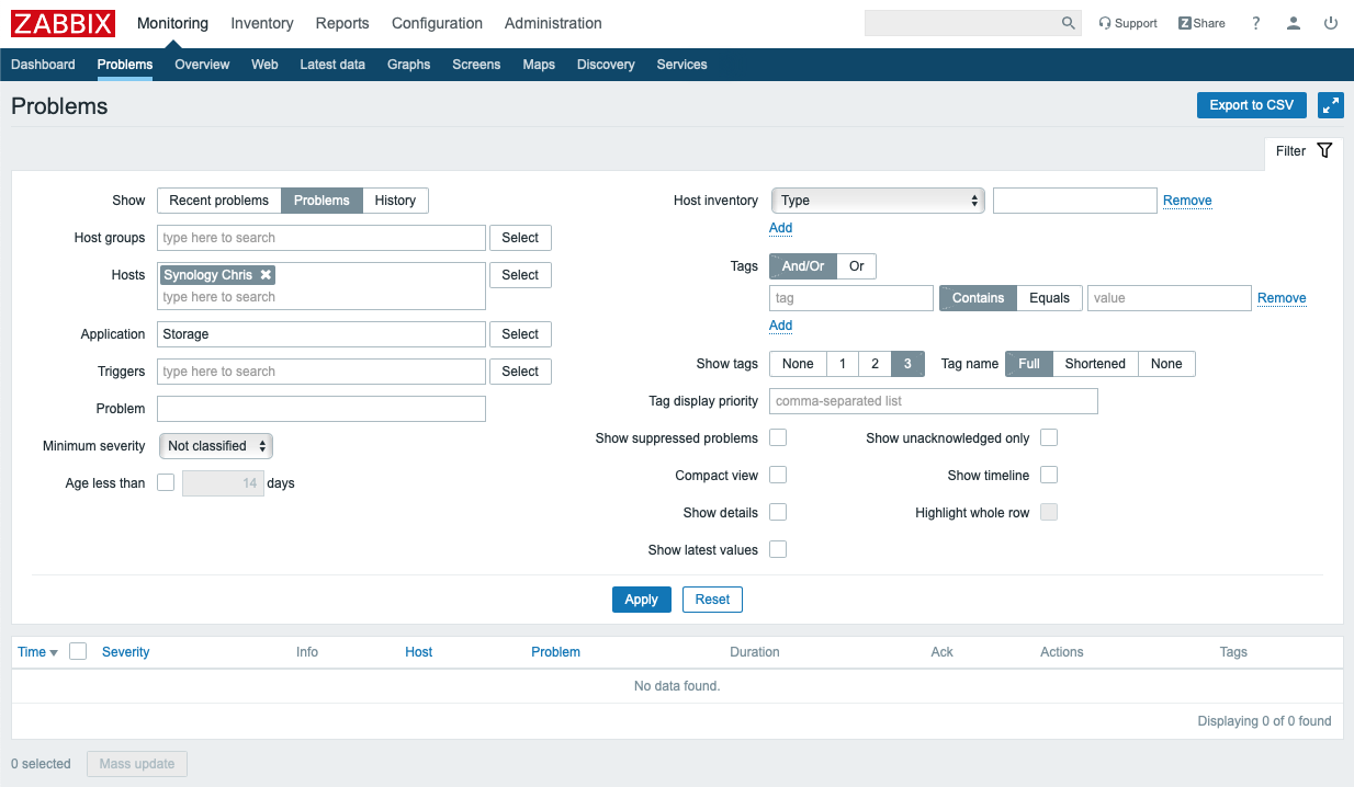

    Hi, in your second image (Monitoring - Problems) you have the Application filter set to "Storage", is that correct, is your icmpping item in Storage application?
    Markku
    • ybizeul
      • Mar 2018
      • 20
      Sorry for the confusion, I was doing some tests wjile taking screenshots. Here is a more representative one.
      Choosing "Minimum severity" or check "Show suppressed problems" doesn't change anything.

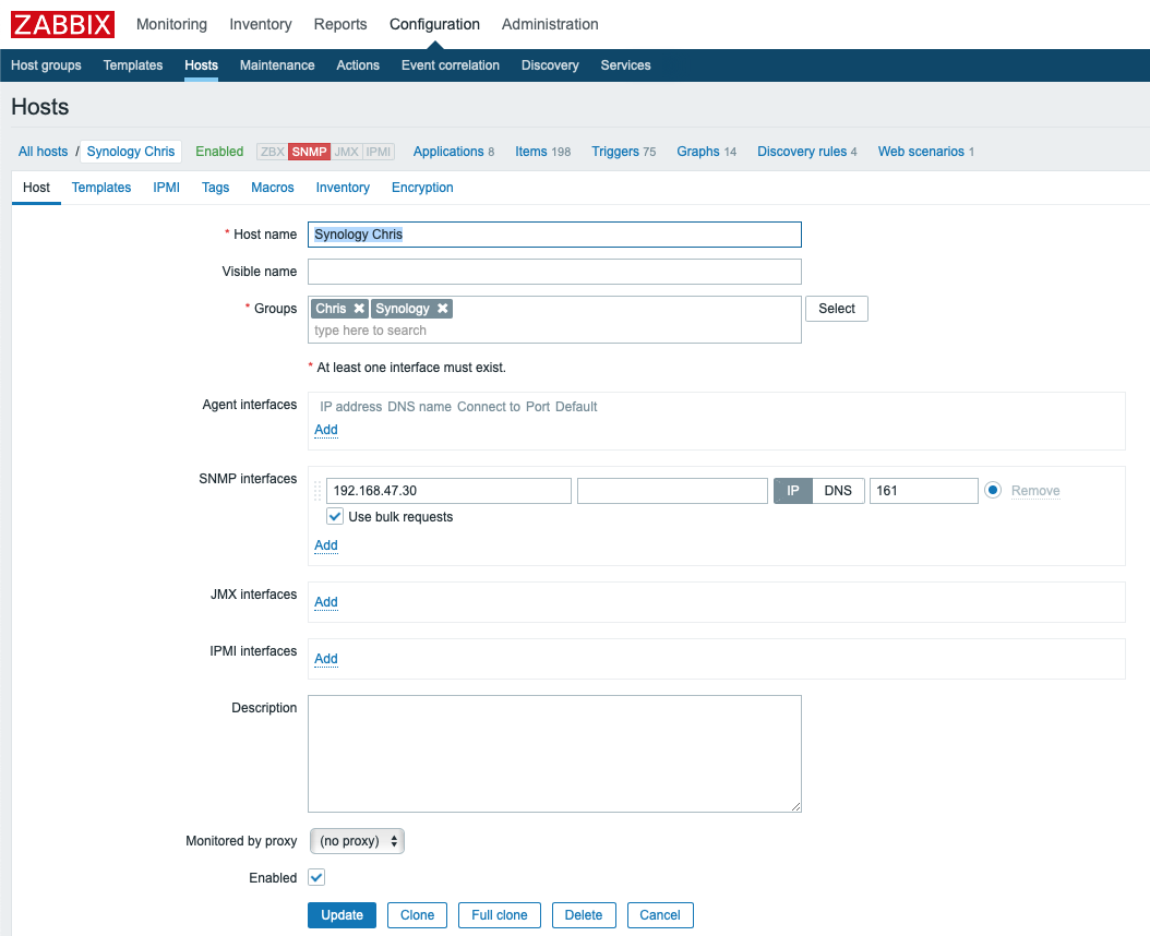

          It's in red because the host is indeed unreachable. Here is the host configuration :
          • Markku
            • Sep 2018
            • 1784
            Right, but again, for me it looks strange that you are using icmpping but have deleted the Agent interface. You know, icmpping doesn't have anything to do with SNMP. Can you try adding the Agent interface IP?
            Markku
            • ybizeul
              • Mar 2018
              • 20
              I think I see what you mean. I think that the actual IP for the host is determined based on any agent type configured, whether it's Zabbix Agent (which is not even available for that device) or SNMP which seemed more appropriate.
              I configured the IP address of that server anyway as an Agent Interface, but after refresh I still get the same result.
