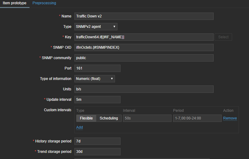

    I'm trying to monitorizing the speed port of the switch with SNMP items.
    I don't use bulk request in host configuration
    The item is autodiscovered through LLD Discovered Rule.
    Thats is a example of my item configuration:
    Click image for larger version  Name:	conf_item_prototypes.png Views:	1 Size:	29.0 KB ID:	383758

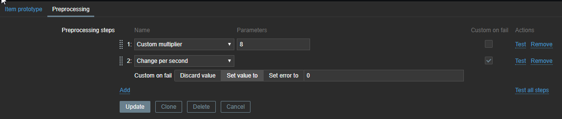

    With preprocessing:
    Click image for larger version  Name:	conf_item_prototypes_preprocessing.png Views:	1 Size:	18.3 KB ID:	383759

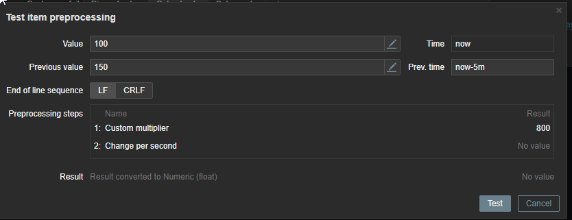

    But I think that Custom on fail feature don't work neither:
    Click image for larger version  Name:	preprocessing_fault.png Views:	1 Size:	18.9 KB ID:	383761
