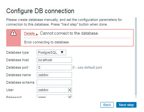

I can not configure Zabbix 4.2 frontend for Postgres 11 on CentOS 7
  • DmitryBobrovsky
    • Aug 2017
    • 17
    OS CentiOS 7. I Install Zabbix 4.2 according to instructions - Download and install Zabbix and Postgres 11 - Linux downloads (Red Hat family).
    In short, it turns out like this:
    # rpm -Uvh https://repo.zabbix.com/zabbix/4.2/r...el7.noarch.rpm
    # yum clean all
    # yum -y install zabbix-server-pgsql zabbix-web-pgsql zabbix-agent
    # yum install https://download.postgresql.org/pub/...est.noarch.rpm
    # yum install postgresql11
    # yum install postgresql11-server
    # /usr/pgsql-11/bin/postgresql-11-setup initdb
    # systemctl enable postgresql-11
    # systemctl start postgresql-11
    # sudo -u postgres createuser --pwprompt zabbix
    # sudo -u postgres createdb -O zabbix zabbix
    # zcat /usr/share/doc/zabbix-server-pgsql*/create.sql.gz | sudo -u zabbix psql zabbix
    # systemctl enable zabbix-server zabbix-agent httpd
    # systemctl restart zabbix-server zabbix-agent httpd
    postgresql.conf
    listen_addresses = '*'
    pg_hba.conf (I already allowed everything that is possible)
    local all all peer
    host all all 127.0.0.1/32 md5
    local replication all peer
    host replication all 127.0.0.1/32 ident
    host replication all ::1/128 ident
    host all all 0.0.0.0/0 md5
    zabbix_server.conf
    DBHost=
    DBName=zabbix
    DBUser=zabbix
    DBPassword=zabbix
    When I try to install the frontend, in step «Configure DB connection», I get an error all the time: Cannot connect to the database (see pic.)
    I CAN connect to the database from my computer, but installer localy cannot.
    Why can't the installer connect to the database? Maybe it problem package - zabbix-web-pgsql?

          Have you configured and tested password login for postgres from localhost?
          • DmitryBobrovsky
            • Aug 2017
            • 17
            Thank. Executed
            [B]# su - postgres[/B]
            Last login: Mon Aug 26 15:55:55 MSK 2019 on pts/0
            -bash-4.2[B]$ psql -h localhost -d zabbix -U zabbix[/B]
            [COLOR=#FF0000]psql: FATAL:  no pg_hba.conf entry for host "::1", user "zabbix", database "zabbix", SSL off[/COLOR]
            -bash-4.2$
            It seems that Postgres is listening on ip6 too.
            Change in pg_hba.conf
            local all all trust
            host all all ::1/128 trust
            it worked. I installed frontend.
            Does anyone know how to disable IP6 for Postgres?
