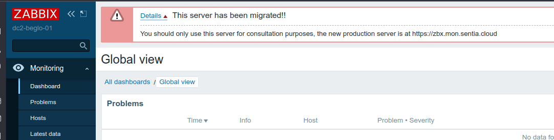

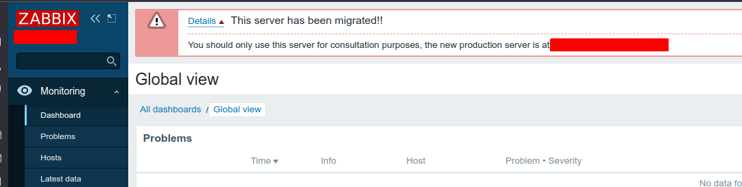

      I just stumbled on the need to do this now, and I realise there is no predefined way to do so... As "aib" suggested, I have some PHP know-how and I was able to make a permanent banner correctly..
      For others looking for the same solution, in order to achieve this:
      you should:
      edit the file: ​ `include/classes/html/widget/CWidget.php`
      and at the end of the file, before the line which returns the function "createTopHeader()" you should add the following:
      PHP Code:
      $msg = [
      'type' => 'error',
      'message' => _('You should only use this server for consultation purposes, the new production server is at https://example.com'),
      'source' => ''
      echo
      makeMessageBox(ZBX_STYLE_MSG_BAD, [$msg], "This server has been migrated!!", false, true, false)->addClass(ZBX_STYLE_MSG_BAD);
      // class options are ZBX_STYLE_MSG_BAD, ZBX_STYLE_MSG_GOOD, ZBX_STYLE_MSG_WARNING
      // respectively are message red, green, yellow
      The next line here should be the return.
      Notice the class options, which are the 3 colours possible.
