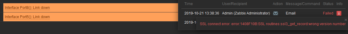

SSL connect error: error:1408F10B:SSL routines:ssl3_get_record:wrong version number
  • GR06LBS
    • Oct 2019
    Dear Ladies and Gentlemen, I hereby request your help regarding my above error code
    in the postfix main.cf the following lines were entered:
    smtpd_tls_mandatory_protocols = !SSLv3
    smtpd_tls_protocols = !SSLv3
    smtp_tls_mandatory_protocols = !SSLv3
    smtp_tls_protocols = !SSLv3
    I cant send Mail on Zabbix Webinterface
    On the server itself i can send an Email per Command Line but not on Webinterface
    But the problem still exists...
    Thank you in advance for your efforts

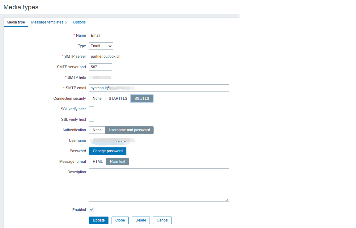

        • David_Yang
          • Aug 2020
Name:	Zabbix Email Configuration-2.png
ID:	417806 Due to we are located in China, so we use the 21vbluecloud base O365, it's different with MS O365. Detail configuration about the zabbix email configuration, please see attachement .

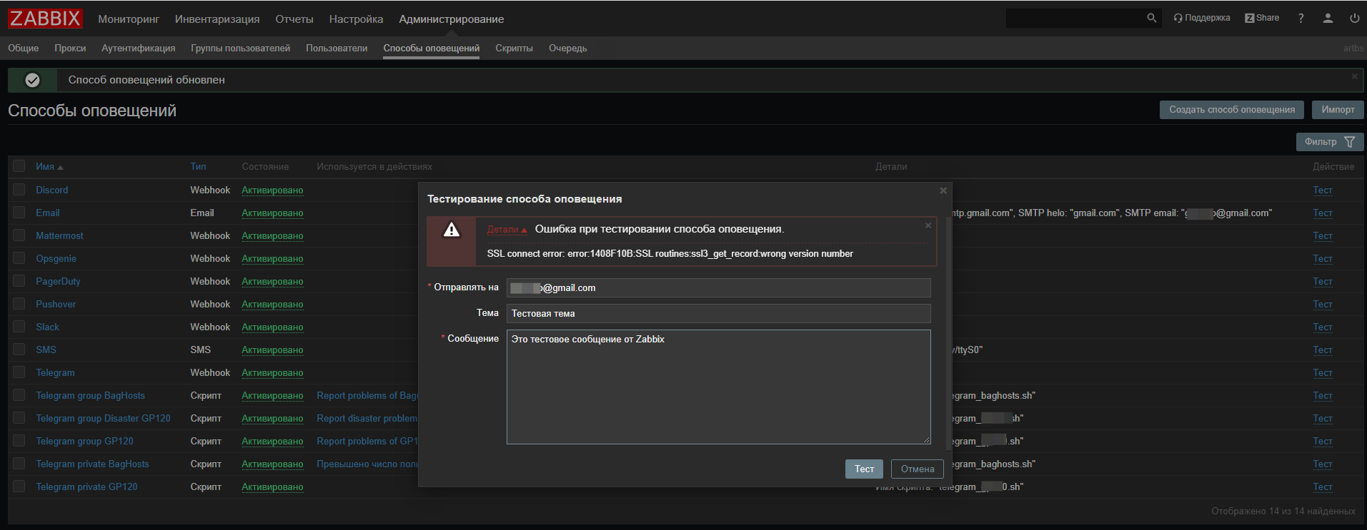

            • Rudlafik
              • Nov 2018
              • 168
              Mayby this help you. I had same problem:
              :Click image for larger version
              • Rudlafik
                • Nov 2018
                • 168
                I try SSL check peer and host and this is work too.
