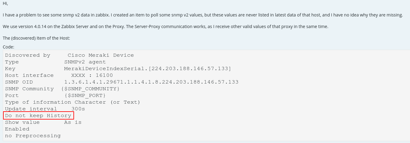

    I have a problem to see some snmp v2 data in zabbix. I created an item to poll some snmp v2 values, but these values are never listed in latest data of that host, and I have no idea why they are missing.
    We use version 4.0.14 on the Zabbix Server and on the Proxy. The Server-Proxy communication works, as I receive other valid values of that proxy in the same time.
    The (discovered) Item of the Host:
    Discovered by     Cisco Meraki Device
    Type             SNMPv2 agent
    Key              MerakiDeviceIndexSerial.[224.203.188.146.57.133]
    Host interface     XXXX : 16100
    SNMP OID         1.3.6.1.4.1.29671.1.1.4.1.8.224.203.188.146.57.133
    SNMP Community  {$SNMP_COMMUNITY}
    Port             {$SNMP_PORT}
    Type of information Character (or Text)
    Update interval    300s
    Do not keep History
    Show value       As is
    Enabled
    no Preprocessing

              • dimir
                Zabbix developer
                • Apr 2011
                • 1080
                • b52
                  • Nov 2019
                  • 15
                  Thanks dimir!
                  Uh, I totaly misinterpreted that "Do not keep History"-Setting
                  I thought it means: Do not keep historical values instead keep only the last value.
                  Manual says, "item history is not stored".
                  I think the option name is confusing and should be more clear. The settings name "History storage period" and the word history is about the past, thus all the values collected in the past, and doesn't say anything about the actual (last) value. Since I don't care about the historical serial numbers of a device, they usually don't change, I set the "History storage period" to "Do not keep History". This says "do not keep historical values" but it means "values are not stored at all". Of course I am interested in the last collected value. This option should be renamed to "do not store values".
                  Further it would be a nice feature to add an option "keep last value only".
                  At least I learned some debugging possibilities of zabbix
                  b52
