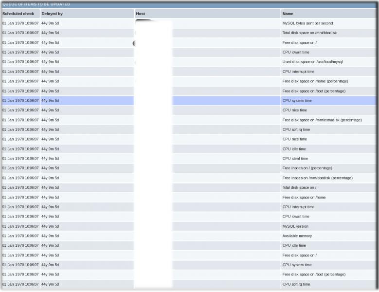

      Then, something interesting showed up in Queue => Details .
      As you can see in the attached file. items scheduled are being delayed for 44 years !!
      Any one has faced such wired detail ?

        See https://support.zabbix.com/browse/ZBX-8488
        • mastraze
          • Jul 2011
          • 30
          Thanks for the link. In fact, I have zabbix 2.2.5 installed : zabbix-2.2.5-1.el6.x86_64.rpm
          Any hint on how to apply the patch ?
          • ingus.vilnis
            Zabbix Certified Trainer
            • Mar 2014
            • 908
            To apply the patch you have to download and save it and then execute the following commands:
            cd <web-interface root folder>
            patch -p0 < <path to the patch>
            However I would simply recommend you to upgrade the whole system to 2.2.6 or 2.4 where the misleading queue issues were fixed.
