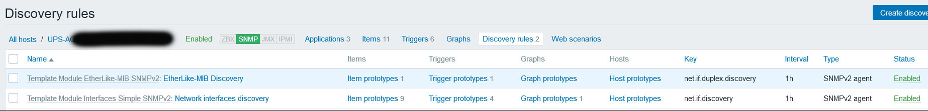

                But I just found this (see screenshot) under one of the affected hosts. Could one of these Discovery Rules be putting too much load on the low end network card in the UPS's?

                  Well, according to the image you have 2 discovery rules that attempt to discover network interfaces of the UPS every hour using SNMP protocol, so that very possibly is it. One thing to find out, which time of the hour those rules are fired. Unfortunately this information is not available in history tables, but you could use some traffic analyzer, e. g. tcpdump to see at what time of the hour SNMP traffic goes between zabbix server and this UPS.

                    So, I have disabled each of those discovery rules independently and left for a 24 hour period, I still have the same results each hour on the hour.

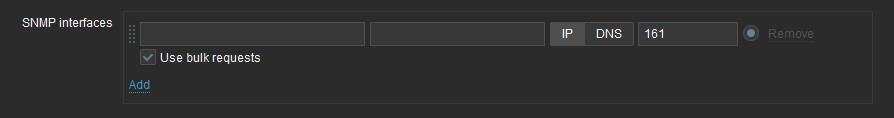

                      Zabbix uses the SNMP GetBulk request to get all SNMP data from the device, instead of the SNMP Get which causes a lot of network traffic. Could it be that the UPS is not able to handle the GetBulk request properly, causing the network stack on the UPS to crash?
                      Edit:
                      Could you please try to disable the bulk requests ? You can do this in the host configuration.

                        Could you try disabling the bulk requests ? You can do this in the host configuration...

                          Since disabling the "use bulk requests" checkbox for each UPS I have not noticed any issues. I will continue to monitor this for the next 24 hours.
                          If this is indeed the solution, is there anyway to disable this setting per host group or per VLAN? Possibly as part of the discovery/action process?

                            The system seemed to behave well during the day yesterday after making the change. However, overnight the same issues have been observed on multiple UPS's.

                              Disabling the "use bulk requests" has actually seemed to make the problem worse. All UPS's are now reporting latency spikes over 200ms on a random timeframe.
                              Does anyone have a suggestion for me? Surely I am not the only person SNMP monitoring Eaton UPS's using Zabbix...
