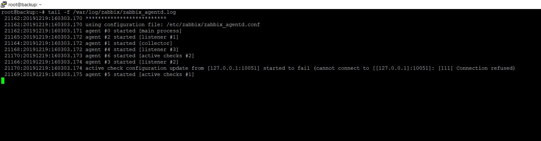

icon zabbix is not green when i active activecheck
is there any error message or log?
For example "Get value from agent failed: cannot connect to [[XXX.XXX.XXX.XXX]:10050]: [4] Interrupted system call"Comment
Agent not working correctly for active type. Is your server installed on same machine? And did you setup your create host configuration correctly? Possiblely that host's lastest value is not receiving right?Comment

In 19th comment as you send, agent trying to connect 127.0.0.1 but your server is not there. Please delete 127.0.0.1 in Server=127.0.0.1,41.227.192.174. There is should be only your server's ip.

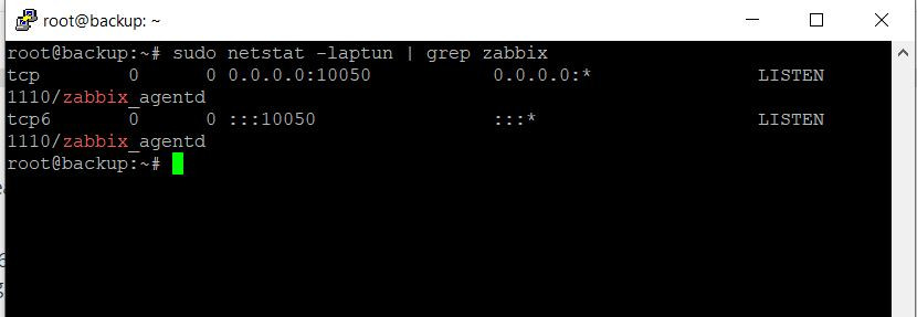

So, your agent is running, but you can't connect to port 10050, which means either:- the agent started no listener processes (StartAgents=0)
- the agent is listening on other port than 10050 (e. g. ListenPort=10060)
- something (e. g. SELinux or AppArmor or something else) is blocking your connection
Code:sudo netstat -laptun | grep zabbix
