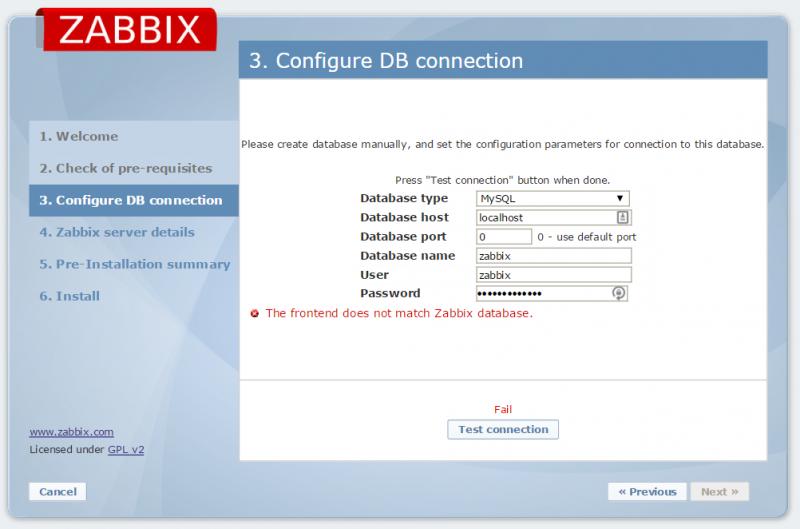

    I recently installed Centos 6.5 as a VBox guest. I then installed Zabbix 2.2 with the package manager. I also installed MySQL 5.1.73 and phpMyAdmin.
    I created a mySQL DB called "zabbix", with collation = utf8_unicode_ci.
    I then brought up Zabbix as localhost/zabbix, which gave me the Installation dialog. On the "configure DB connection" page, I put in my root password for MySQL.
    When I clicked on "Test connection", I get the message "The frontend does not match Zabbix database. I've searched everywhere, in this forum and elsewhere, but I can't find an explanation for this message.
    What does this mean and how can I fix it?
    UPDATE: zabbix log entry: [Z3001] connection to database 'zabbix' failed: [1045] Access denied for user 'zabbix'@'localhost' (using password: NO)
    But I can't find what's causing this

    Frontend error zabbix 2.4
    I haver same problem with zabbix 2.4.1 when i try to install it . I can log in the database with zabbix user , so its intresting what is this problem .
      Configure DB connection: frontend does not match Zabbix database
      with Ubuntu 14.04 and zabbix 2.4 same problem:
      The frontend does not match Zabbix database during step 3 configure DB connection ...
        installation error: frontend does not match Zabbix database
        My solution :
        ref:https://www.zabbix.com/documentation...all/db_scripts
        drop existing zabbix db
        then
        shell> mysql -u<username> -p<password>
        mysql> create database zabbix character set utf8 collate utf8_bin;
        mysql> quit;
        shell> mysql -u<username> -p<password> zabbix < database/mysql/schema.sql
        # stop here if you are creating database for Zabbix proxy
        shell> mysql -u<username> -p<password> zabbix < database/mysql/images.sql
        shell> mysql -u<username> -p<password> zabbix < database/mysql/data.sql
        after that step 3 is ok...
