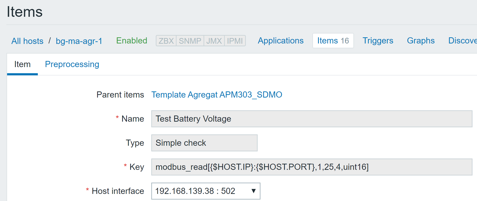

    After I created an Item in Host and Key of that Item that looks like
    modbus_read[{$HOST.IP}:{$HOST.PORT},1,25,4,uint16]
    I get an error message: Not Supported: Network is unreachable.
    Zabbix documentation says:
    2 The {HOST.*} macros supported in item key parameters will resolve to the interface that is selected for the item. When used in items without interfaces they will resolve to either the Zabbix agent, SNMP, JMX or IPMI interface of the host in this order of priority, since Zabbix 3.0.6.
    My Item inherited the Host's IP and PORT:
    When I put the IP address instead of macros:
    modbus_read[tcp://192.168.139.38:502,1,25,4,uint16]
    I receive the correct value of register 25.

    According documentation {HOST.PORT} not supported in item key.

        Let's not confuse 2 things there:
        • built-in macros (e. g. {HOST.HOST})
        • user macros (e. g. {$HOST.HOST})
        In the macros of your item key you have the dollar sign, which means that is a user macro. User macros are supported in item key parameters but they need to be defined somewhere (on a host, its template or globally): https://www.zabbix.com/documentation...ros/usermacros . So if you define them, you will be good. Currently, if not defined, they will be left as is and since they are neither address nor port the metric will fail.
        If you would like to use build-in macros, as Hamardaban said, {HOST.HOST} is supported in item key parameters and {HOST.PORT} is not. See this page for list of build-in macros and where they are supported: https://www.zabbix.com/documentation...ed_by_location
