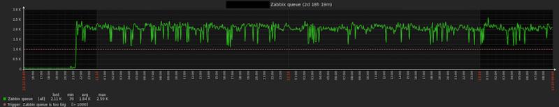

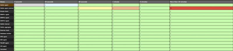

    I have a weird issue with my Zabbix 2.4.0 reported Queue values.
    As you can see in the attached Screenshots bellow when you look at the Zabbix internal Queue size value graph you get ~2.5K values in the queue.
    At the same time when you go to Administration > Queue the values you see there are way much lower.
    Any ideas why I have such discrepancy in those values? In a way How I could troubleshoot this?
    Thanks,
    jansonz

    Do you use some Zabbix proxies? The queue values could come from them.
    • jansonz
      • 53
      Nope, I'm not using any proxies...
      At the moment the situation seems better since I upgraded Zabbix to 2.4.1 - from that moment I haven't had the queue issue anymore...
      Will keep you posted.
