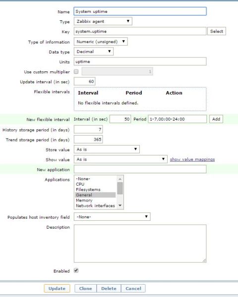

    So, this is an issue I have run into in both old versions of Zabbix (1.4.x) as well as a brand new install that we just finished (2.4.1). Essentially, it seems like system.uptime overflows on Windows hosts and causes issues in ALL items / triggers / graphs on that host, not just uptime.
    The setup:
    The stock/default 'System uptime' item that comes in the 'Template OS Windows' template with Zabbix (Item.jpg).

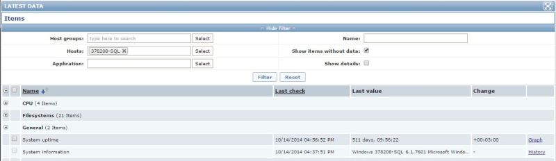

    A Windows host with a long uptime, in our case it is currently 511 days (LatestData.jpg).

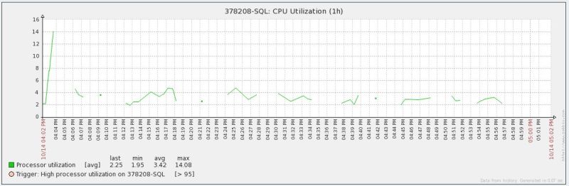

    This causes drop outs in data, graphs, and triggers going off incorrectly, usually the "this host is unreachable / unable to contact Zabbix agent for 5 minutes". A good example is gaps in graphs (Graph.jpg)

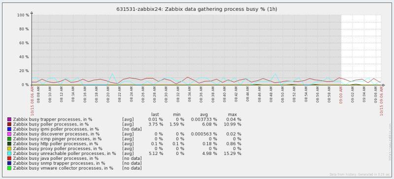

    Can you take a look at the very last paragraph (and the graphs) of this post, and then see how your internal processes are being utilized?
    I would be interested in seeing your graphs with a 1 day time period.

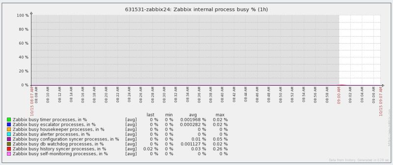

        Check the last paragraph regarding internal Zabbix processes.

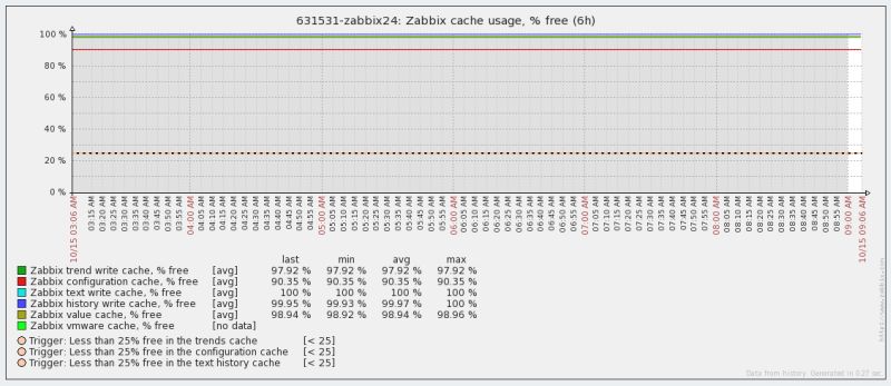

          I read that post (and looked at those graphs) before I posted the thread. From what I can tell (if I am reading them correctly), they don't seem to indicate any issues - images attached.

            Those all look good.
