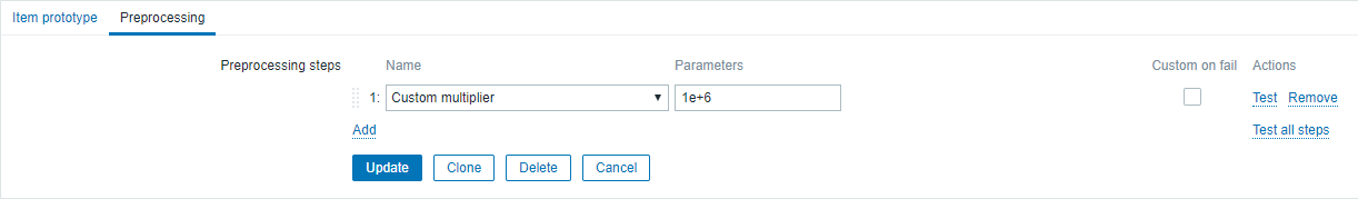

    I found the answer myself, just in case someone reads this question:
    ifHighSpeed yields the speed in Mbps, so for an interface that is 100Mbps the actual result is 100, it is possible to use preprocessing in the item reading ifHighSpeed and use multiplier with value 1,000,000
    as shown below:
