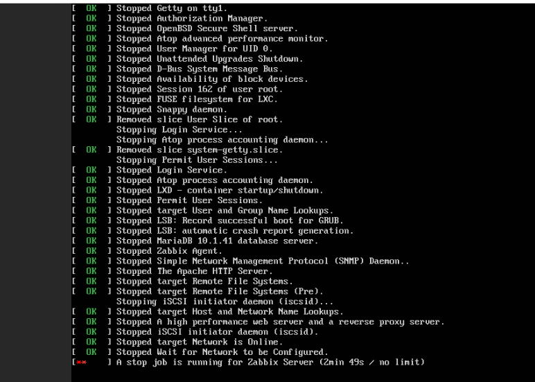

    I was wondering if someone else has had this issue before, i reboot or shutdown the server it wont it stays stuck on trying to stop the zabbix service see picture, the zabbix server running 4.4 on ubuntu 18.04

    If the database server stops before zabbix_server stops, there is a problem that zabbix_server cannot stop. If you are running Zabbix server and database server on the same server using systemd, you should add zabbix_server first by adding dependencies in Zabbix server startup file.
    ZBX-15602 : SystemD TimeoutSec=infinity can be bad
    ZBX-16078 : Zabbix hangs at shutdown

      Which version are you running? It is told to be fixed in 4.4.4.

        thanks for the reply 4.4.1 what i did was adding the timeout to 30s in the service of zabbix i guess ill update it to fix it

          See also https://support.zabbix.com/browse/ZBX-17105 if you go to 4.4.4: the graphs will look a bit incorrect. There is a workaround mentioned (using the 4.4.3 php file or using the file from the latest master branch in git.zabbix.com).
