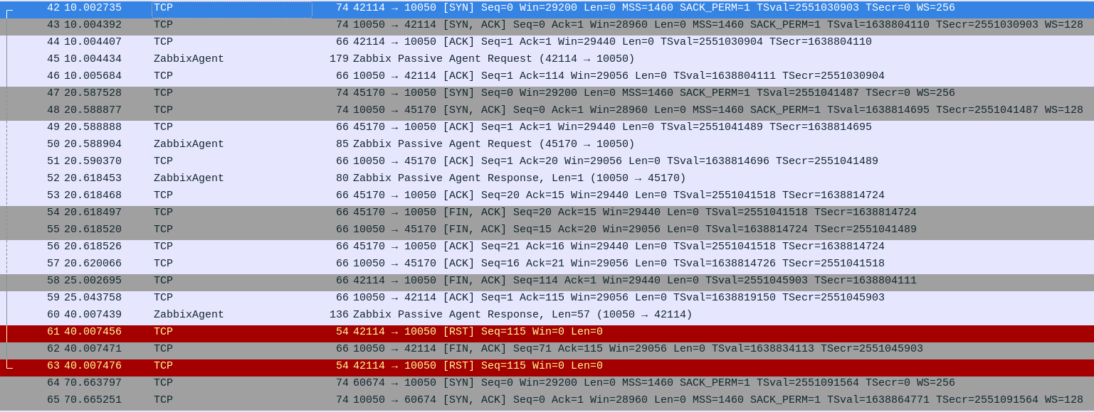

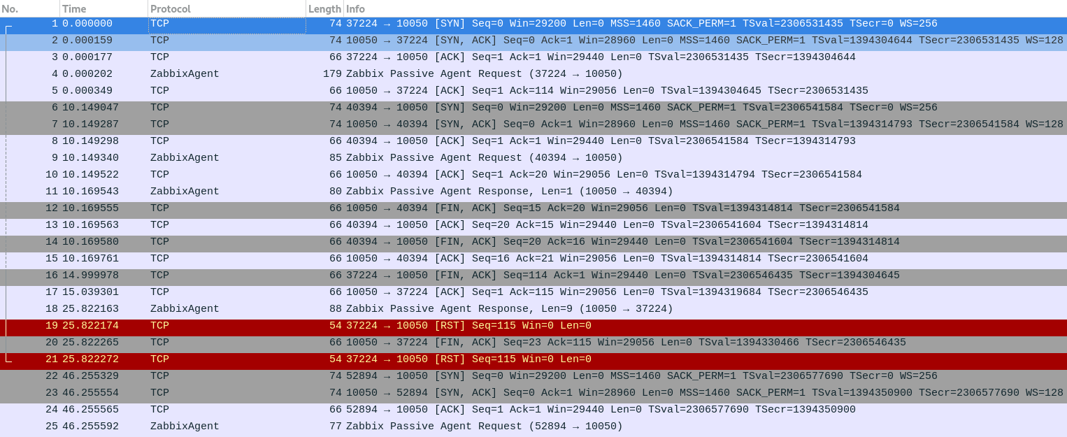

            Attached is what I'm seeing from the server-side packet captures.

              Now there is some interesting output, in the session with Zabbix server-side port 37224:
              • In line 4 the server sends the item request
              • Agent ACKs that packet immediately in line 5 (= it certainly received the request)
              • In line 16 (almost 15 seconds later!) the server apparently has had enough of waiting and sends FIN to close the connection, which is ACKed by the agent in the next packet
              • In line 18 the agent eventually sends the response, 25 seconds after the actual request
              • The server responds with a reset because it is not expecting anything anymore (the response is most probably discarded in that case).
              Compare to the session with port 40394, in which the response comes much faster, practically immediately.
              So, check inside packet number 4, which item does it contain that makes the agent wait for such a long time before responding.
              Markku

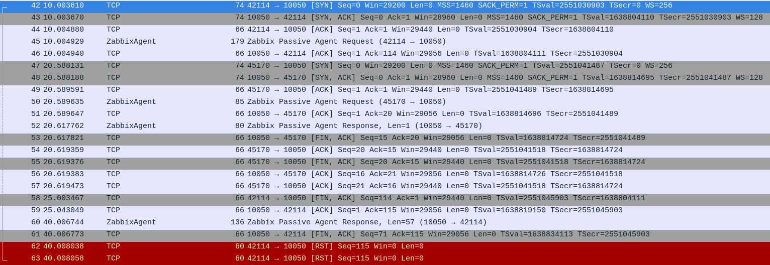

                  I just used at(1) to synchronize a packet capture. Here's another example of one of these resets, but from both sides.

                      Ok, in the agent-side capture we see:
                      - A large request is received in packet #45 (session with port 42114)
                      - Agent does not do anything for it until packet #58 (15 seconds later) where it FINs the session = looks like it wouldn't do anything for it, maybe agent-side timeout kicks in?
                      - HOWEVER 15 seconds later (#60) the agent sends the data but as we see in the server-side #61 the server does not accept it because the agent already sent the FIN earlier. Thus the data does not get handled at all.
                      Again the question: What request was that and why the agent just sat over it? What is in the response?
                      The other session in the agent-side capture (with port number 45170):
                      - Request was received in #50
                      - It was responded to immediately in #52
                      - Everybody was happy in the connection-level.
                      What did that request and response contain? Is it shown in the Latest data?
